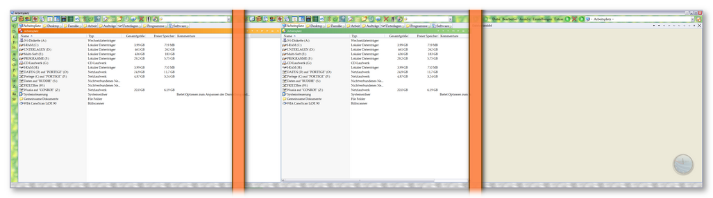

Hi forum,

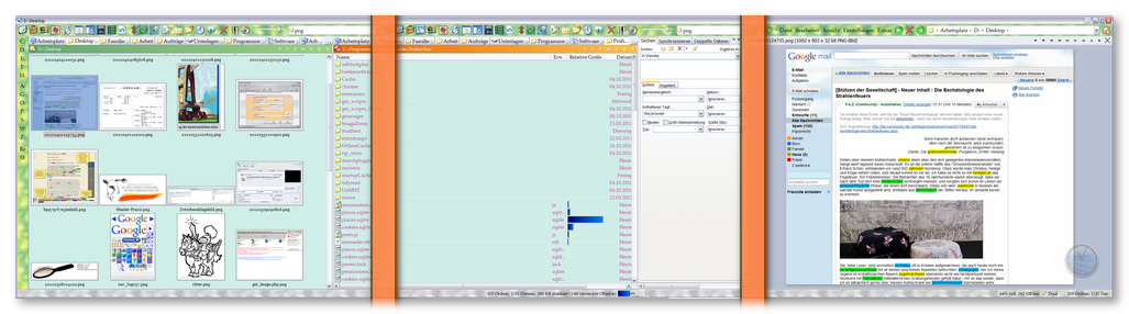

I'd like to have the search pane only turning up and taking up space in the Lister which actually is the parent to the search. Instead it seems that the search pane always spans both listers, which is inconvenient if the two listers are rather wide, see below with my tree monitor setup.
Any thoughts?
David.P

Click the = or || icon next to the panel's close button and it will switch to a vertical layout. (I think it may appear after the viewer, rather than before, though. And that option is going away in the future as, except on unusual setups with a single window spanning multiple monitors, the vertical layout was felt too thin to be useful.)

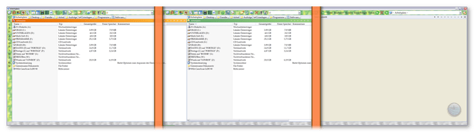

Not so good. In this case, the listers get resized and don't fit the three monitors anymore, see below.
Sorry, I don't seem to understand any of the above.

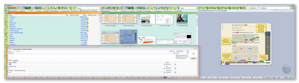

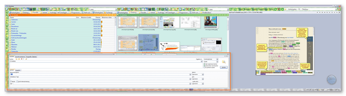

If i resize things to fit the pane dividers with the monitors, and then close the find pane, I get this :frowning:
Ah, true; I didn't think of that.
I don't think there is a way in that case.
Thanks :confused:
I guess you could do it using Lister Styles to toggle between the two states.
i.e. Instead of opening/closing the Find panel directly, switch between two styles, where one has it turned on and the other has it turned off. The styles store the positions/sizes of things so that should work.

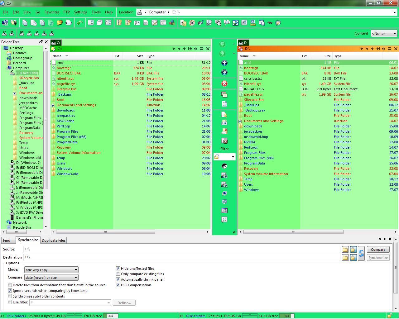

Perhaps a picture would help:
This is how the Find/Sync/Dupes panel looks on my system. How is this not wide enough to be useful?

In your screenshot, your Sync panel is in the horizontal layout. This isn't changing. You just won't be able to change the Find/Sync/Dupes panel to a vertical layout any more.
Not sure how to explain it any clearer than that...
You will still have the choice of left/right or top/bottom file displays.
The viewer can still be on the right or at the bottom.
All that's changing is that the Find panel will have to be below the file displays (just like it is in your screenshot). You will no longer be able to put the Find panel to the right of the file displays.
