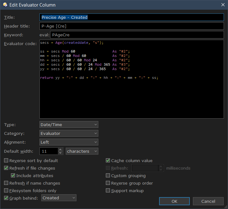

Evaluator Column Code - Time from Creation Date to Today's Date
This produces no output. I think it's a problem with the first line of the Evaluator code but I don't know a fix. Ideas?

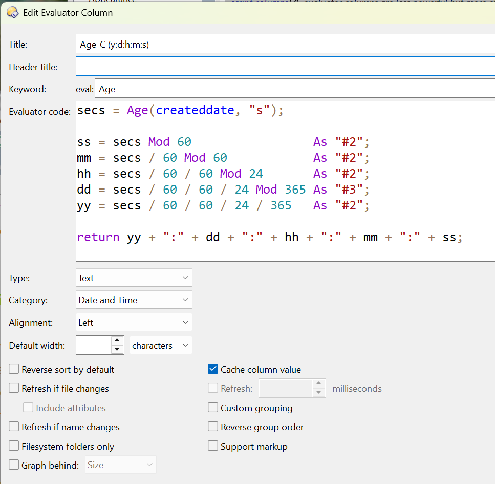

Your code is working here.
The first line of your code also works fine by itself.
Maybe try to write it again as a new Evaluator Column ?
There's a similar column here. Perhaps you can identify the bug by comparing the two?

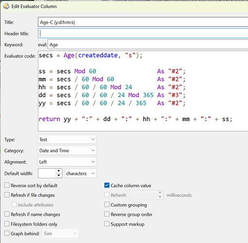

Your exact build works here. For what it's worth, here's my build from the thread @lxp mentioned:
Other than the title and a few parameters, the code itself is the same.
