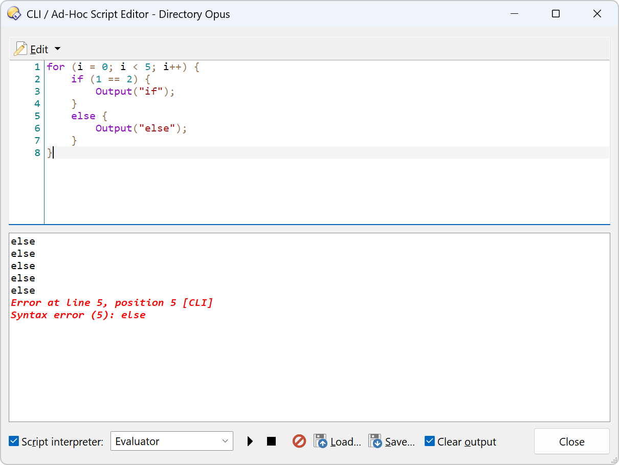

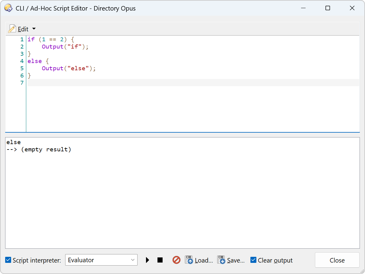

This works fine on its own:
if (1 == 2) {
Output("if");
else {
Output("else");

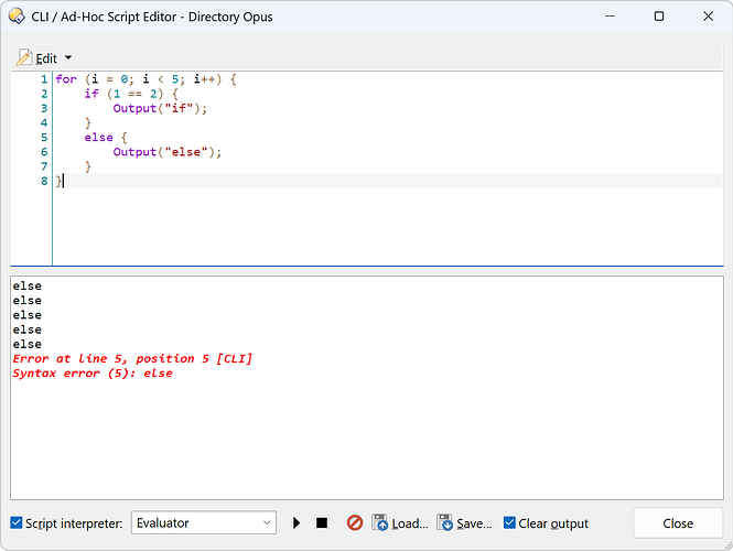

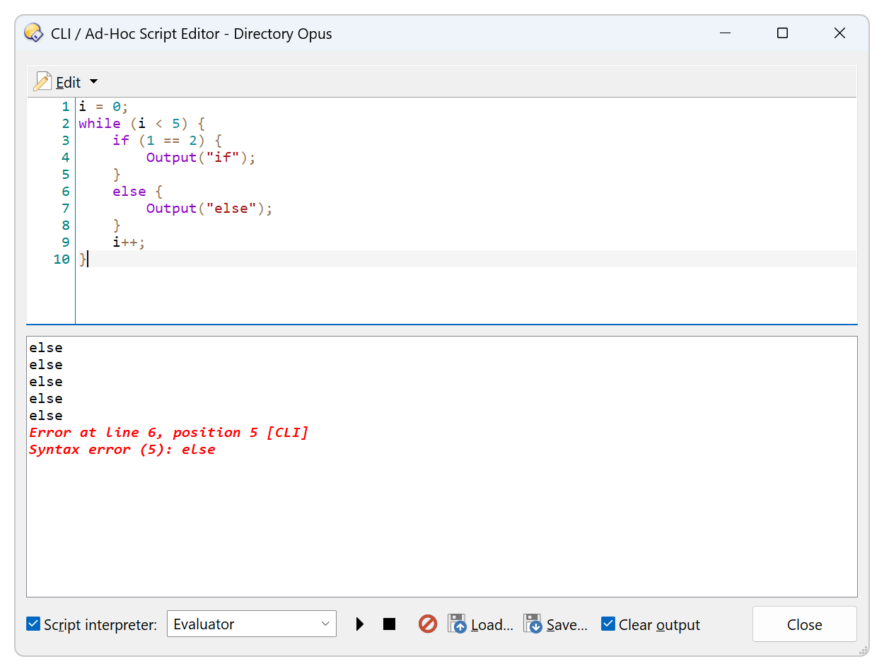

Running it inside a loop ends with a syntax error:
For
for (i = 0; i < 5; i++) {
if (1 == 2) {
Output("if");
else {
Output("else");

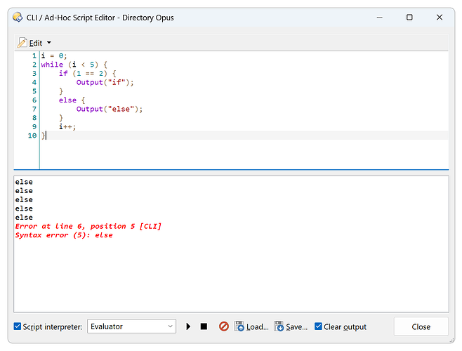

While
i = 0;
while (i < 5) {
if (1 == 2) {
Output("if");
else {
Output("else");
i++;

Jon
October 30, 2025, 6:16am
2
Thanks, fixed in the next update.

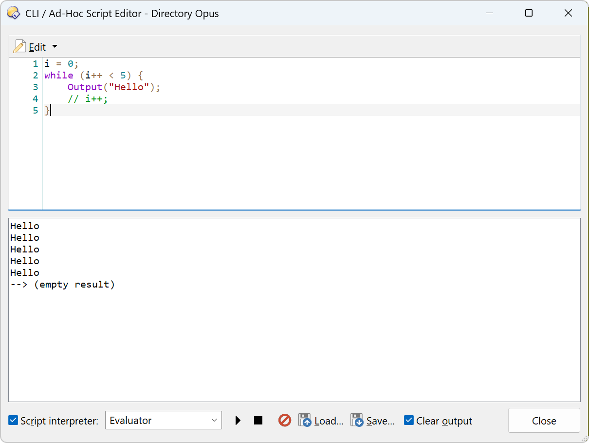

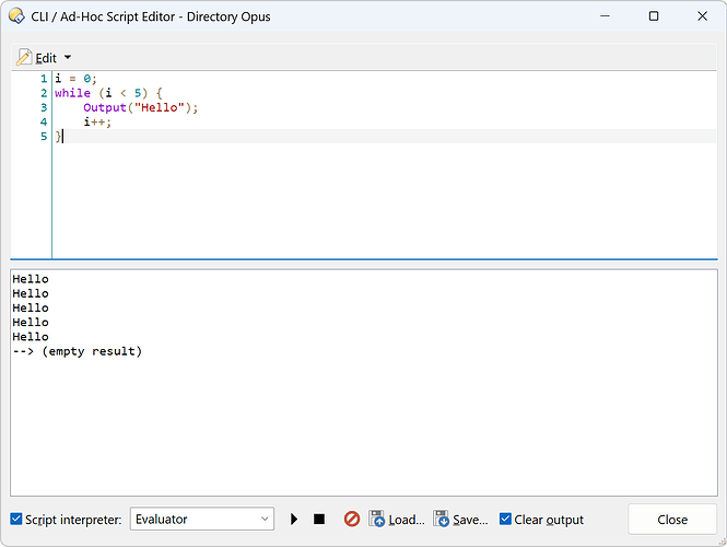

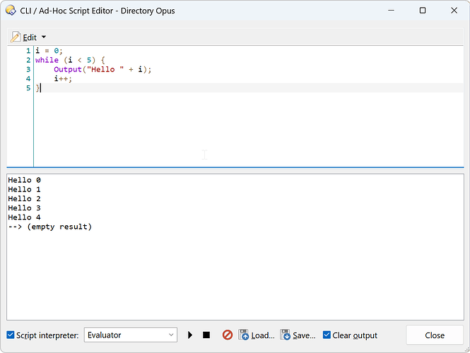

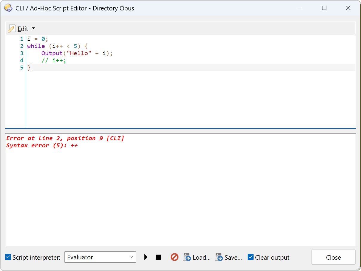

Let's play with the While loop a bit more.
i = 0;
while (i < 5) {
Output("Hello");
i++;

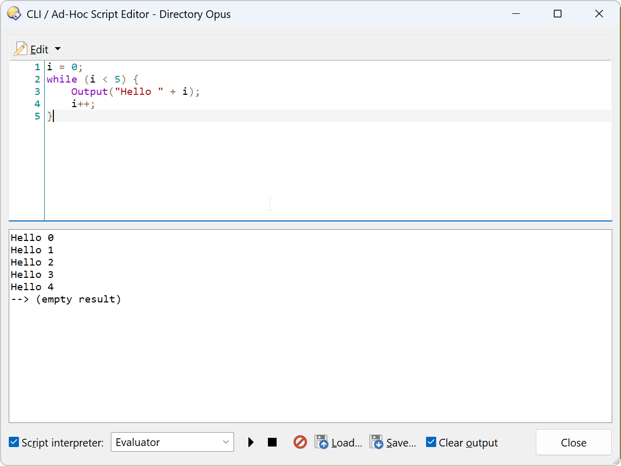

We can enhance the output a bit:

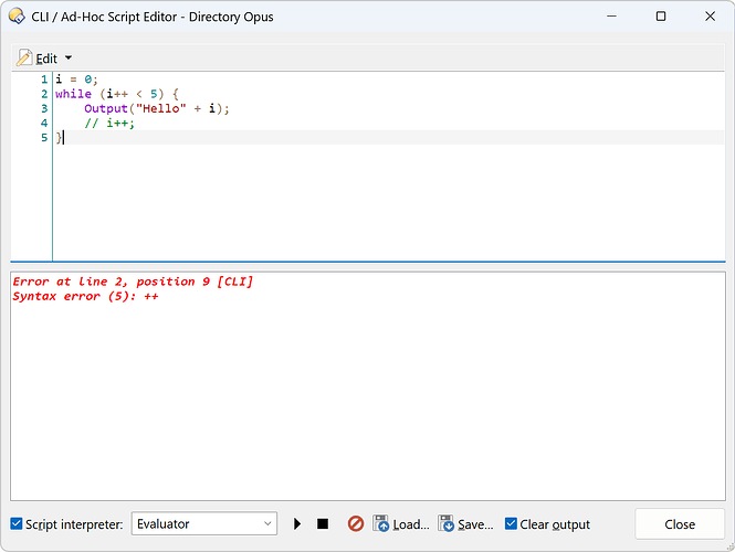

We can check and increment the counter in one go:

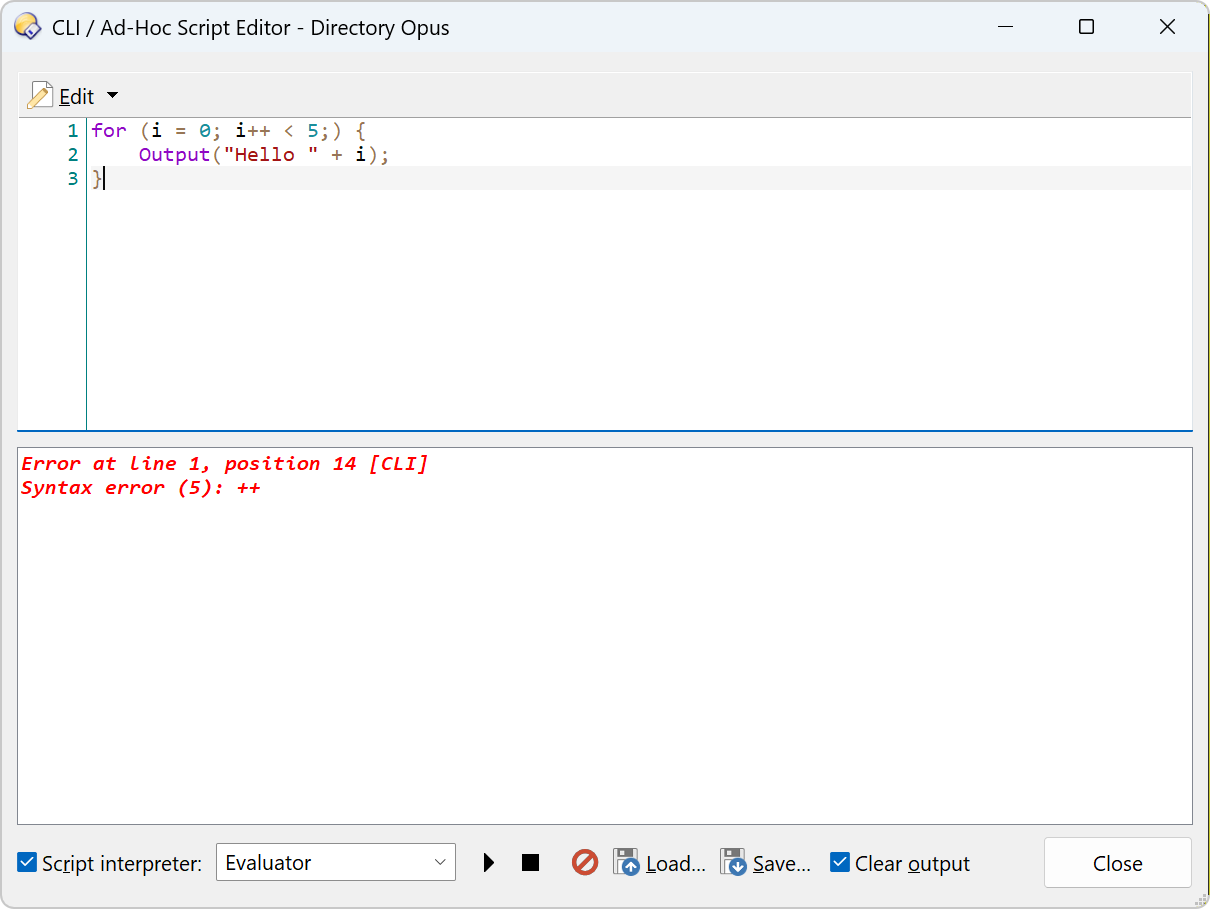

But we can't do both:

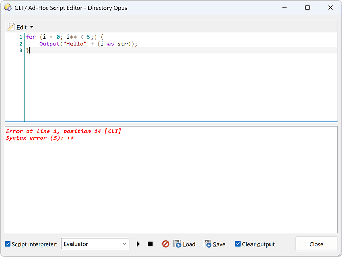

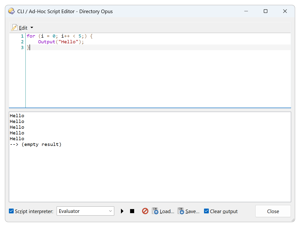

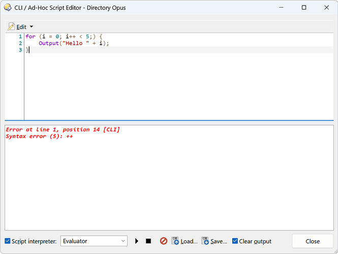

The For loop behaves similarly, but the coding style is a bit awkward:
for (i = 0; i++ < 5;) {
Output("Hello");
Not on a computer to test: what about casting i as str in the Output statement?

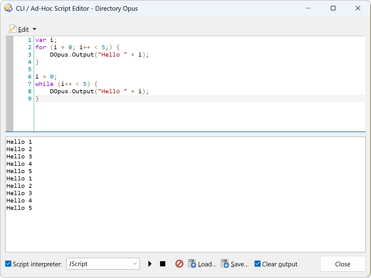

BTW, JScript is cool with this style.
var i;
DOpus.Output("Hello " + i);
i = 0;
while (i++ < 5) {
Jon
October 31, 2025, 2:21am
9
Thanks, fixed in the next beta!
