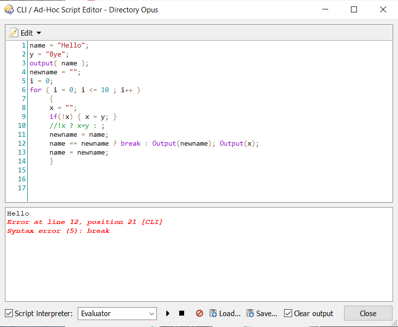

I am very confused here.
This topic is the result of some fun tinkering I have done after two other recent threads.
What got this started was a discussion of regular expressions. It forced me to rethink some things. Thankyou !
More recently there was this thread asking for a Null coalescing operator.
I am kind of able to isolate the problem I have found, but in other attempts I have made to isolate it I have failed !
Here's my simple attempt to isolate the problem:

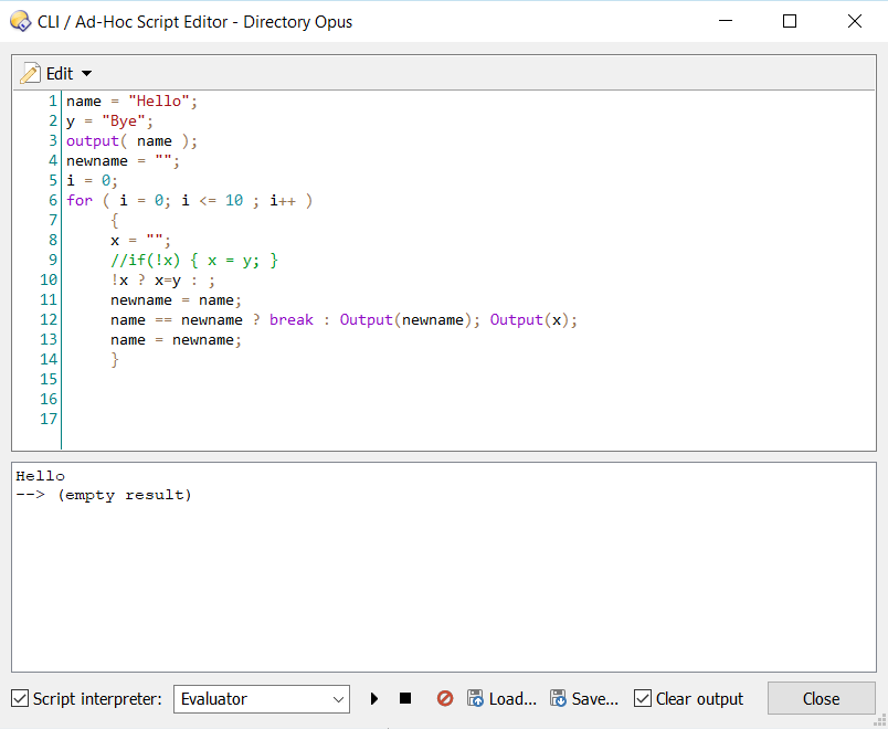

But when I use the Ternary Operator it works !
But this result isn't always the case !

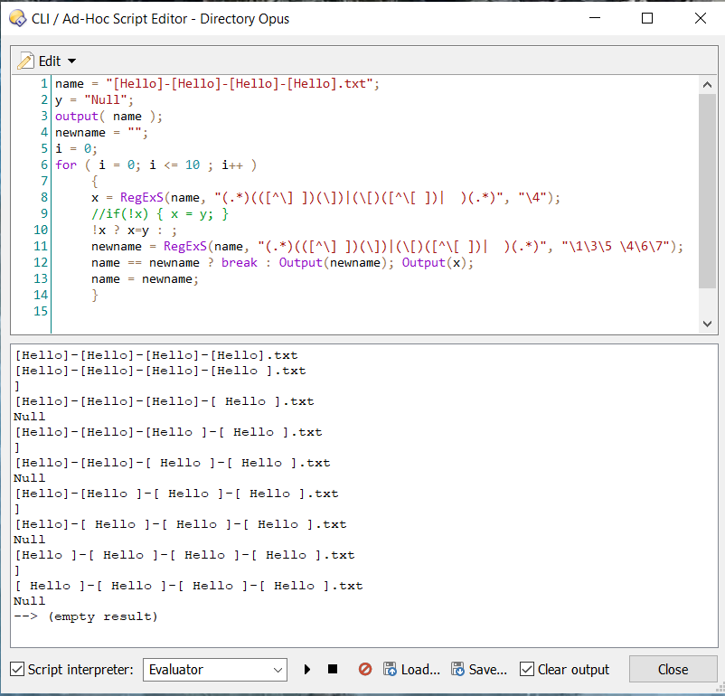

I have been able to use If clauses within For Loops !
I still have not isolated this problem.

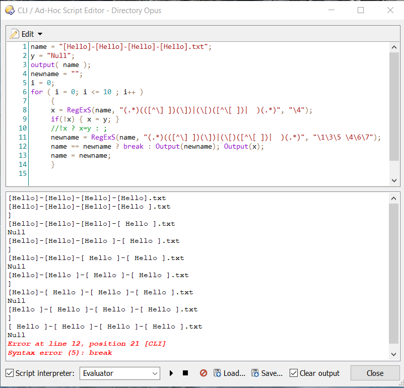

Am I doing something wrong ?
This started with this.
But the Ternary Operator works.
YEAH !
Am I missing the obvious ?

The error's coming from line 12, not the if statement.
name == newname ? break : Output(newname); looks a bit weird, not sure if that will work properly or not.

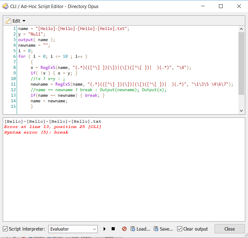

What happens if you change that to if (name == newname) { break; } ?

Sorry, but ....
Same error with the simple version.
Are you missing a semicolon at the end of your if statement (line 9)?
Ok, got it. Fixed in the next update. Thanks for the report.
PS: It makes it easier to test evaluator/script problems if you provide the code in text form rather than a screenshot :wink:
@lxp
It is if(!x) { x = y; } which is the same as
if(!x)
   x = y;
But yes, I also wondered if a semicolon at the end of line 9 would help.
I tried it. It didn't make anything worse, but it didn't fix it either.
