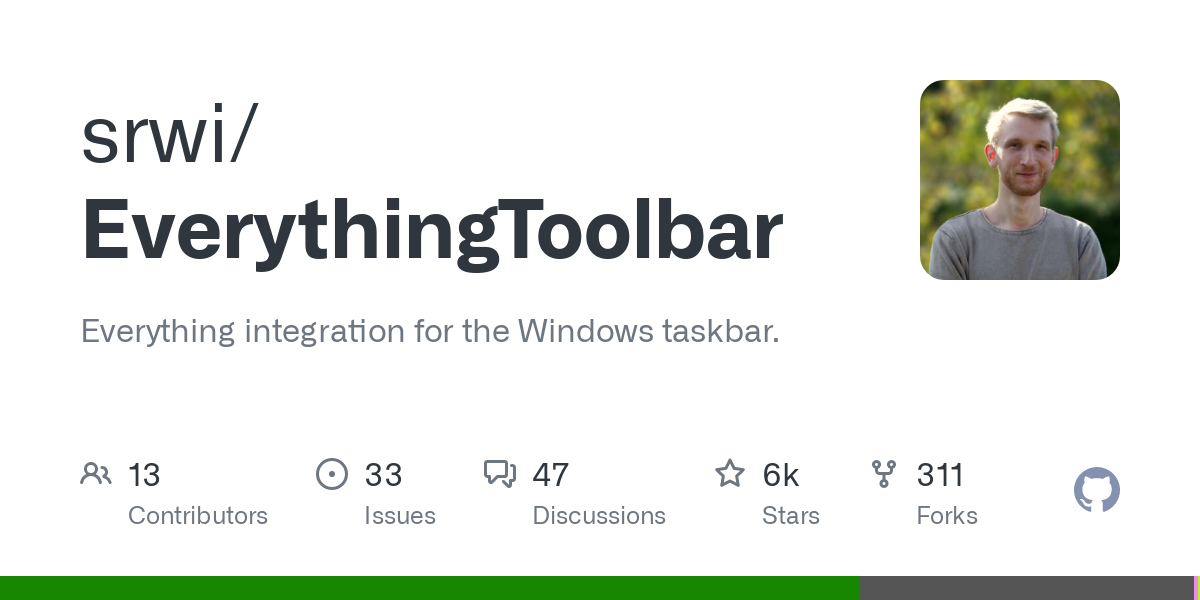

Am I correct that in DO it's not possible (or not necessary for majority) to create such dynamic search as it's in original Everything app, which searches as you type, while here we define query and execute it?
look at this.
Currently you can use AutoHotkey to open the Everything interface to search, and then send the results to the DOpus collection. (Obviously this is out of scope for this thread)
Wow, thanks. Maybe will try it eventually. (But probably will stick to OG app, because I like extensive result lists)

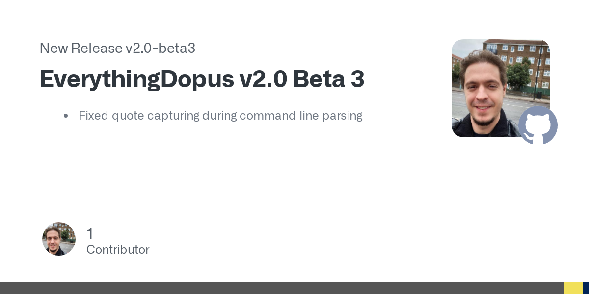

Updated to v2.0 beta 3 - It fixes some issues with quote parsing when running from cmd (I was testing on powershell only). This also fixes some issues with trailing slashes in quoted paths.

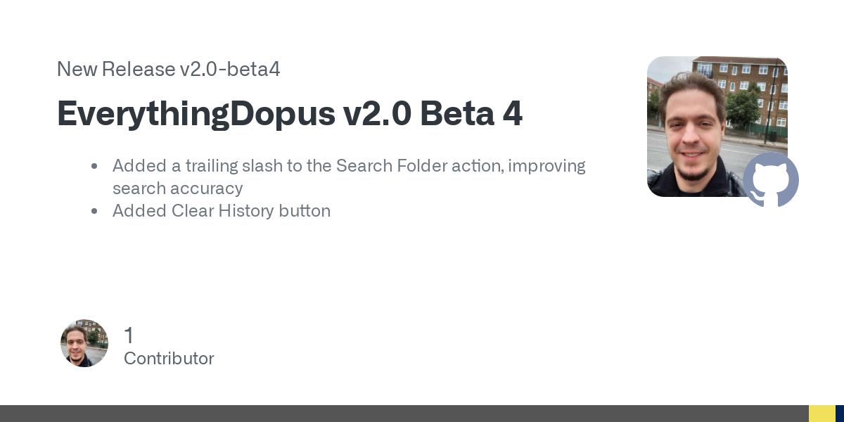

Added v2.0 Beta 4:
- Added a trailing slash to the Search Folder action, improving search accuracy
- Added Clear History button
