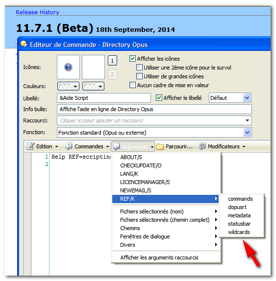

the title already says it: Could you add a new option to the Help REF command that links directly to the Scripting reference section in the Help file, similar to 'commands', 'metadata' etc.?

...not a very important addition, obviously, but it would save me (and perhaps some others?) a lot of always-the-same-clicks, particularly since leaving the Help open is not an option because it still tends to jump in front of everything else unwanted (see [url]Some command put Help on top of program]).
Plus I hope it should be fairly simple to add...

[quote="MartO"]Hi DOpus Team,
