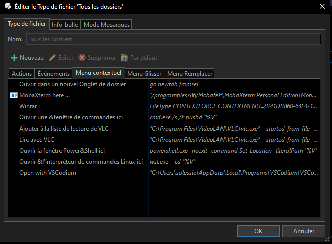

Hello PassThePeas. Where to from here?
Double click "All Folders".
It opens :
Go to the context menu tab, click "+ New"
Type : Opus Function
Give a name (and an icon if you want) to the action
Function : Standard function
In the editor, type in the function you prefer (here is just CreateFolder)
Then you can decide where it will appear in the menu.
