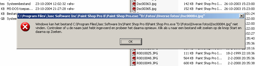

I tried this shortcut key thingy, to open my images in Paint Shop Pro 8, using the hotkey P.
But when I do that, I get an error report, saying that Windows can' t find the program. In this error report, i see the path of Paintshop, followed by the path for the JPG I try to open. See attached file. Oh, the error message is in dutch, so only focus on the string part :wink:
Now if I edit the function for the hotkey and remove the "%1" string, only Paintshop starts, and it's not showing the selected file (or files). So, what's going on? any ideas?
Robert
Try putting quotes around the path to Paint Shop.
Thanks Jon, that does the trick!
