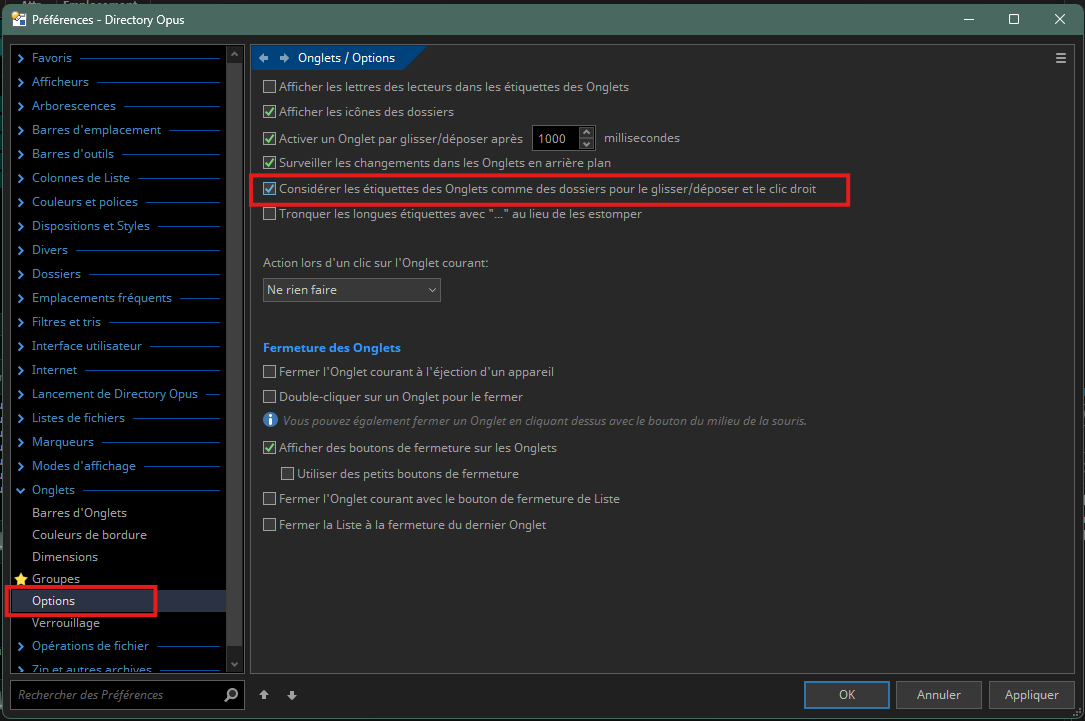

That's coming from the fact you probably have enabled the labels of the tabs to be considered as folders for drag and drop.

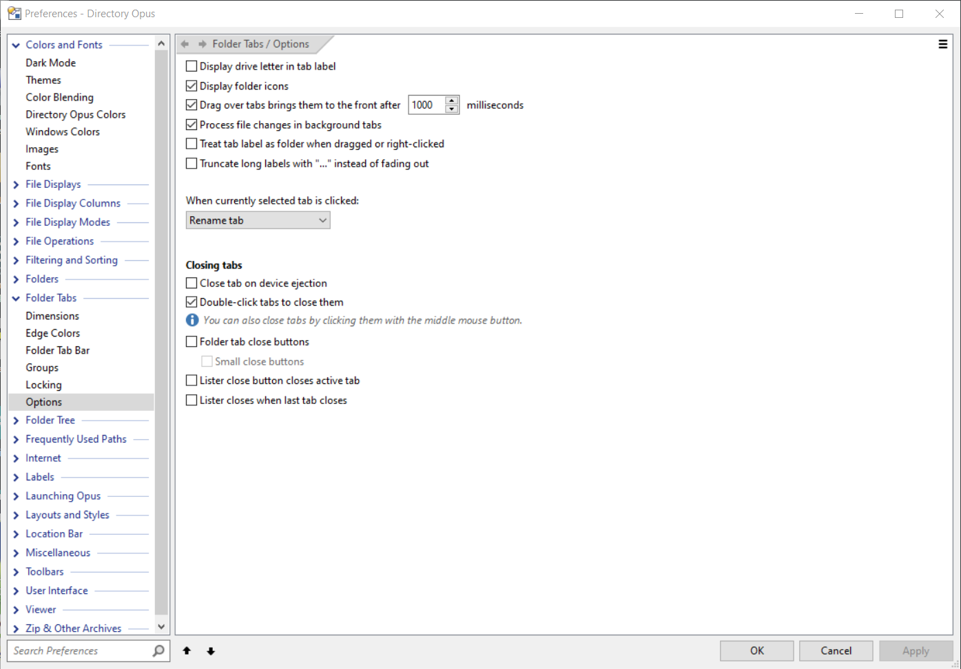

You have two options:

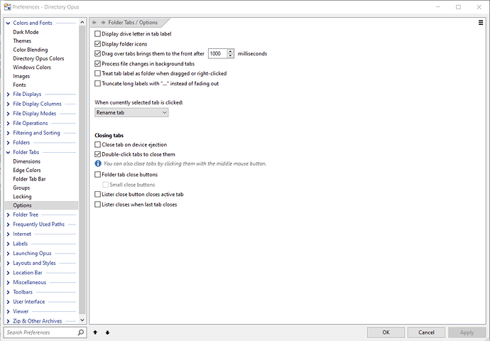

First one is to disable that: Settings/Tabs/Options then look at the screenshot below.
The other option (which I prefer) is to move the tabs by selecting their icon instead of their label/name.

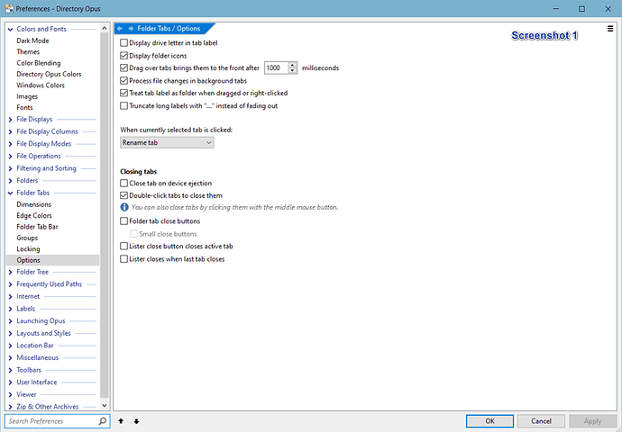

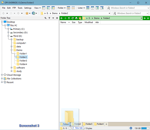

In Screenshot 1, I chose the option ON, "Treat the label as folder when dragged or right-clicked" in this demo.

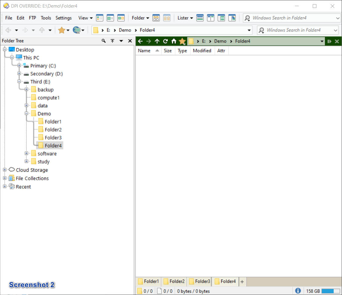

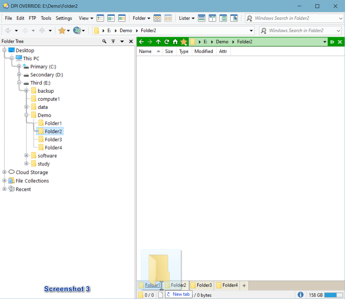

In Screenshot 2, I created 4 folders, shown as 4 different folder tabs.
In Screenshot 3, I am dragging "Folder4" tab between "Folder1" and "Folder2". As you see, "New tab" context message gets shown while I am dragging, but very carefully.

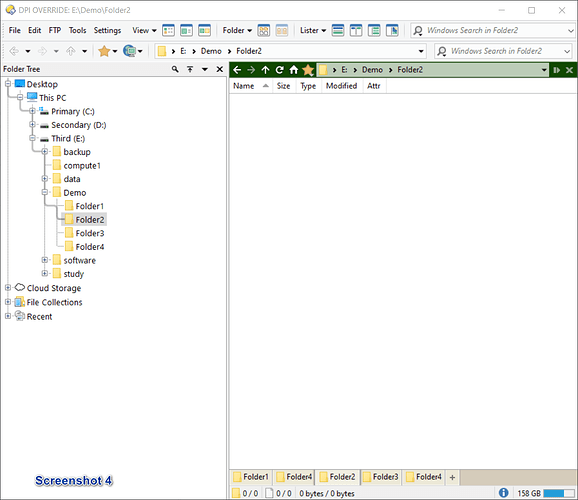

In Screenshot 4, I dropped it between the "Folder1" and Folder2" tab. However, a new folder tab has been created instead of moving the "Folder4" tab itself.

In Screenshot 5, I disabled the option "Treat the label as folder when dragged or right-clicked" as PassThePeas suggests.

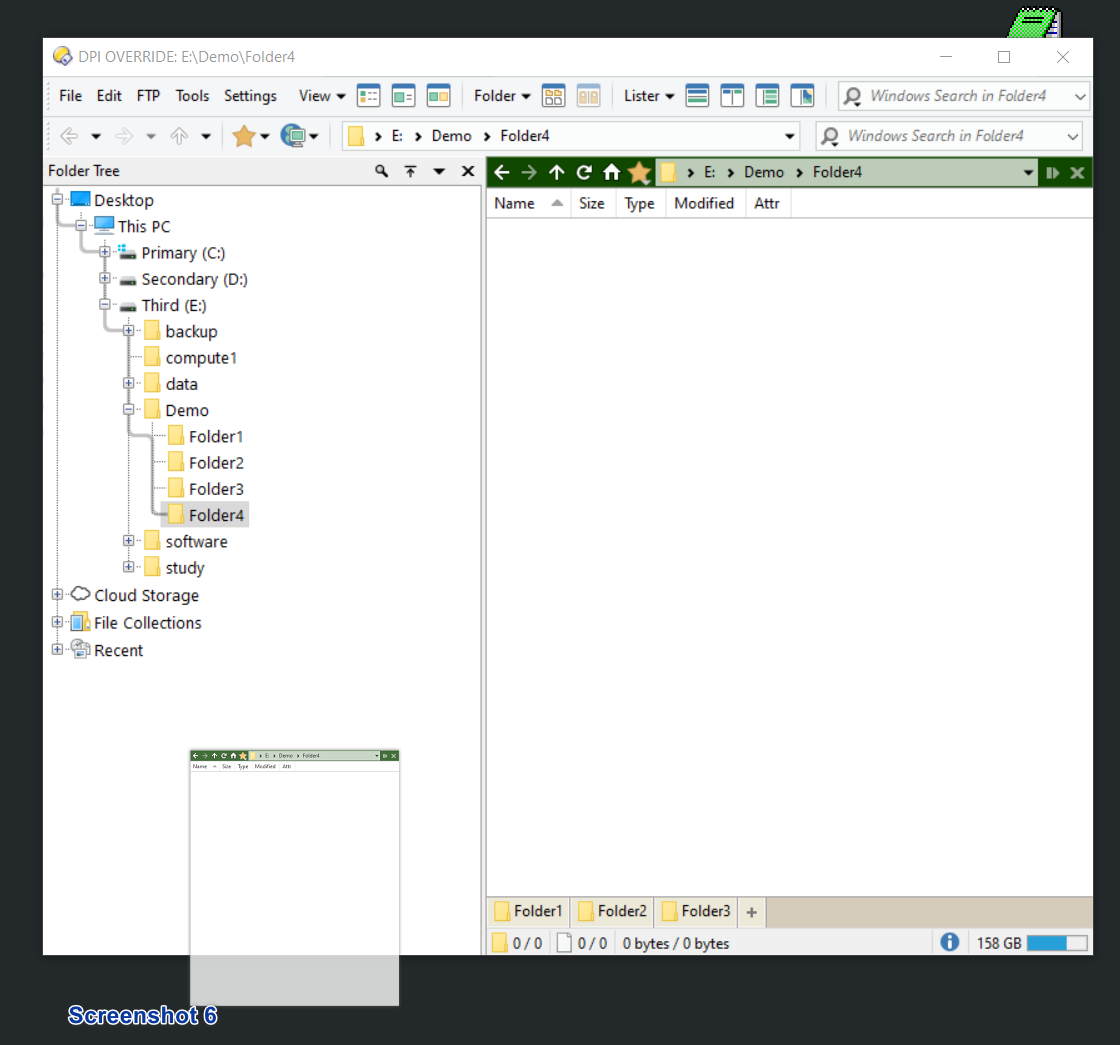

In Screenshot 6, I click and drag the "Folder4" folder icon (but not the "Folder4" label). As you see, there is no context message "New tab" shown while I am dragging. Though not shown in the screenshot, my mouse cursor is between the "Folder1" and Folder2" tab.

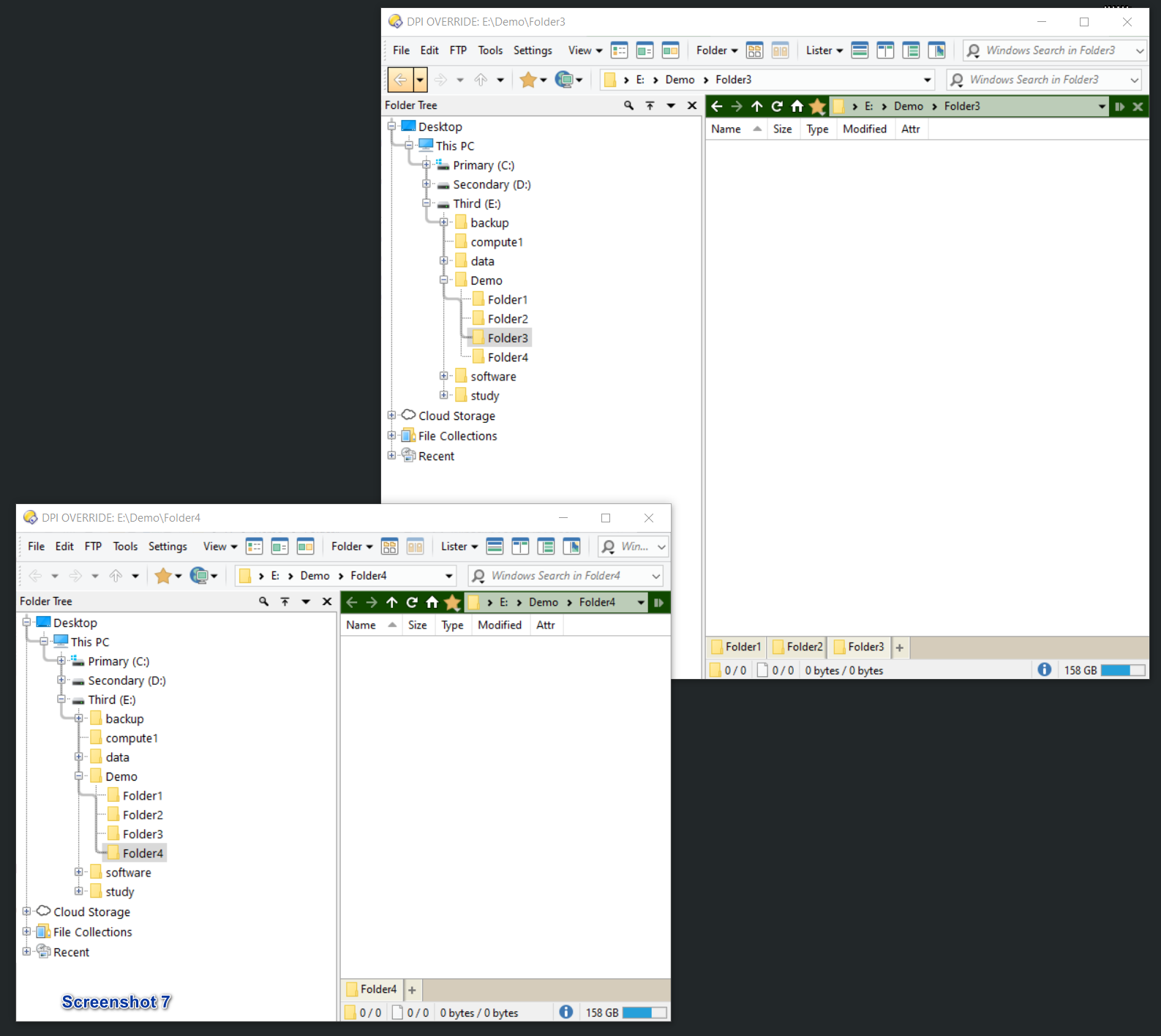

In Screenshot 7, I dropped it. However, a new lister of "Folder4" is up instead of moving itself between the tabs.
In sum, the "drag-and-drop" action event in a Directory Opus lister in my laptop always ends up with a new lister created up, instead of moving a folder tab.

Considering the screenshot #6, it may be something related to DPI.

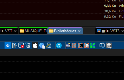

On this screenshot, the tab you're moving is not in a state where it can land in a new tab bar: you can see that because you have some kind of a shadow window with a small lister.
If you drop in that state, this will create a new lister.
When you're over a tab bar, that shadow lister window disappears, and you only get the tab itself drawn on screen.
Since you're saying your mouse is over the tab bar at that moment, only thing I can think of is something related to DPI : what you see is not what Opus sees.
You could try to move vertically the mouse "on a virtual line crossing the current lister" to try and find a spot where the shadow window disappears and if/when found, drop the window.
This would only confirm but won't be really usable ...

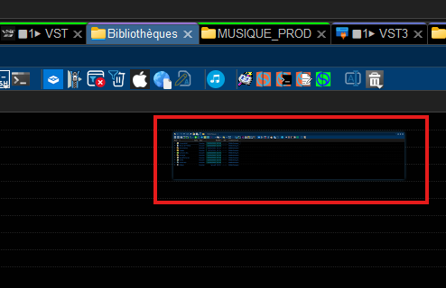

Screenshot when moving the tab over the tab bar (mouse not shown, but is on the icon of "Bibliothèques" while dragging):
Screenshot when moving the tab somewhere else (mouse not shown but is in the top left of the shadow lister appearing over the current lister that tab has been dragged from - in the drawn red rectangle):
EDIT2:
Looking at your screenshot #6 again, what seems strange is that you're saying the mouse is between folder1 and folder2 tabs, and the shadow lister is nowhere near that.
Do you confirm the "shadow lister window" upper left corner is not attached to your mouse pointer and moving with it?

No. Though my screen capture did not catch my mouse pointer, my mouse pointer was between Folder1 and Folder2 tab, as similar to Screenshot3. Whatever I click and drag (folder icon or folder label) if with the option OFF (shown in Screenshot 5), it always ends up with like Screenshot 6.

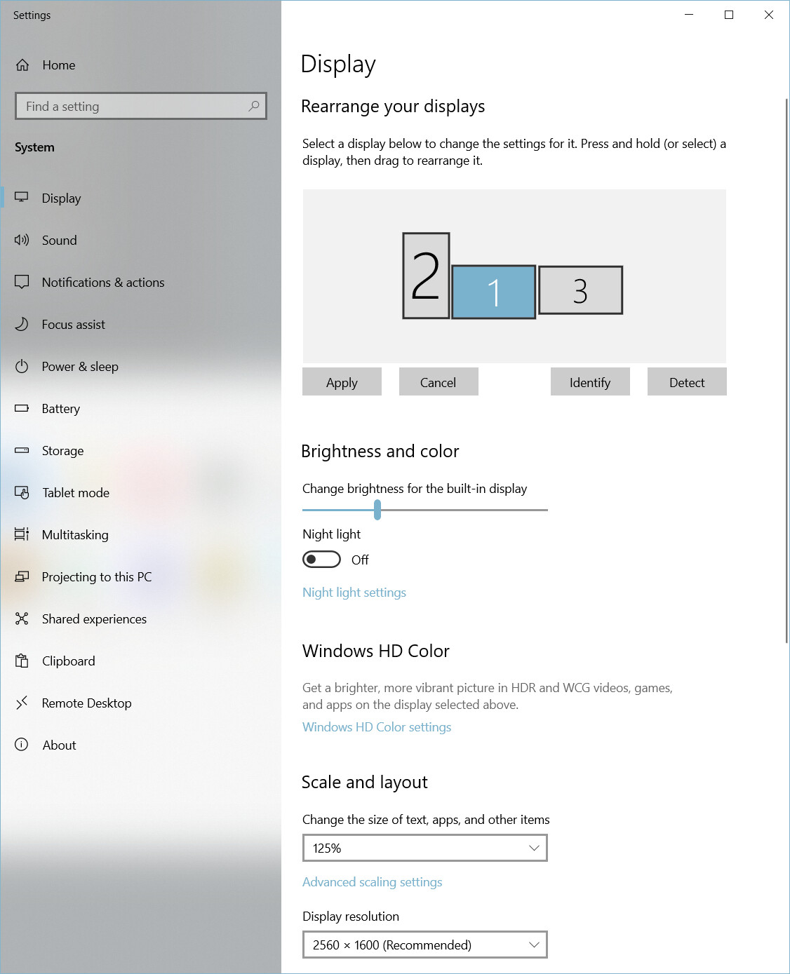

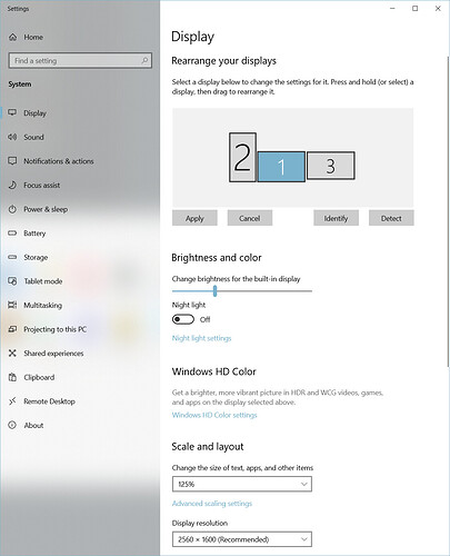

Thank you for your feedback. Below is the specification of my monitors, including a laptop as the primary one by which I made this demo.
Primary monitor of my laptop
17" WQXGA (2560 x 1600)
2560 x 1600 in use
125% scale
Two secondary monitors
27" Quad HD (QHD, 2560 x 1440)
2560 x 1440 in use as landscape and portrait display orientation
100% scale
I could not find which DPI for each monitor, but you should be able to estimate it from the monitor size and their native display resolution.
For information, I attached a screenshot for the primary monitor setting.
In sum, I have upgraded Opus 13 version from Opus 11. After upgrade, Opus 13 folder tabs won't move in all 3 monitors with the setting of Screenshot 5 (or 5th screenshot). Instead, the drag-and-drop always ends up with creating a new lister shown in Screenshot 6 and Screenshot 7. Although not captured in Screenshot6, my mouse pointer is located between Folder1 and Folder2 tab as like in Screenshot 3 example.
