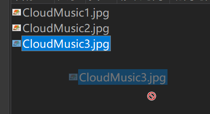

Under normal circumstances, the "COPY MOVEWHENSAME" command should be executed. However, in the state shown in the figure below, the "JPEGView.exe {filepath}" command should be executed.

Simply press and hold the file, drag it, and then release the mouse button. (As shown in the figure: the red prohibition icon appears.)
