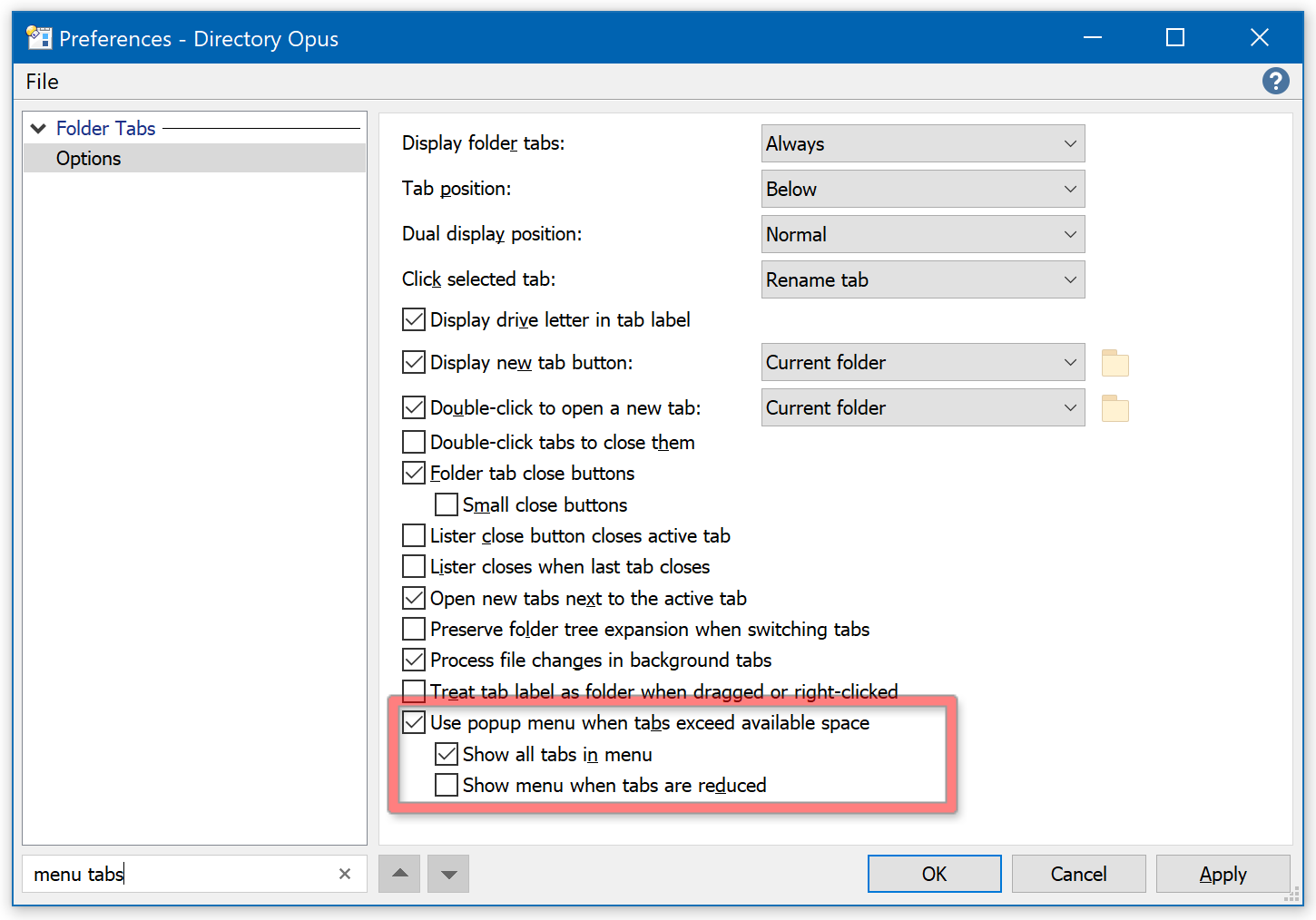

You could always create a drop-down menu that lists all the open tabs. That would atleast save you from having to use the left/right scrolling.
Create a button that runs something like Go TABLIST="icons,nameonly". Then place that button in a New Menu item to make it a drop-down list.
TABLIST command arguments: https://www.gpsoft.com.au/help/opus12/index.html#!Documents/Go1.htm
There's an option for that built-in:
I'll give that a try, with so many options it will take a while to avail myself of all the possibilities!
