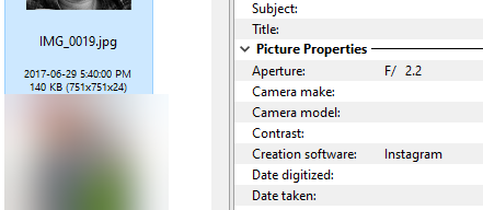

Date Taken: I display 'Date Taken' under photo thumbnails, but if the photos does not have a Date Taken, the Date Created is displayed. Please change that! If I view photos in Details mode, and there is no date Taken for a Photo, the field is left blank, so I think it should be left blank under thumbnails.

To state it differently, If I choose to display Date Taken, I believe only Date Taken should be displayed, and not a substitute/different date.
Please fix this!
OR add an option that matches how it works now - Display the file/system Date Created or Date Modified , whichever is earliest when there is no Date Taken.

Only Date Taken should be displayed if Date Taken is what was selected to be displayed in Preferences. It's deceptive to display metadata from another date field if there is no Date Taken.
There is so much confusion and misinformation about photo date metadata, and this does not help!

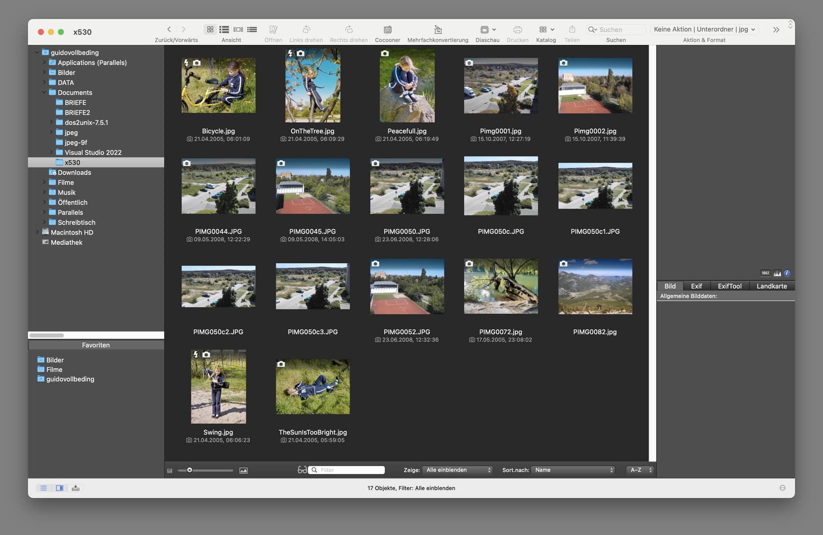

If you want more options, see GraphicConverter on the Mac:
Now I select Date Taken and Date Modified:
and add them to the label:
The result is this:
But if you do this in DOpus, please retain the option as it is now.

"As it is now", Opus will a display a date in the Date Taken field under a thumbnail even is there is no Date Taken--even when no Date Taken is displayed in Details view.
If the Directory Opus developers intend to correct the wording in preferences for displaying Date Taken under thumbnails but not change what is displayed, the wording in preference should match the manual, which does say that a Date Modified will be displayed if there is no Date Taken.

No, I think this is misunderstood.
If I ONLY select EXIF date for display in label in GraphicConverter, then NO date is displayed whatsoever when there is no EXIF date:
I understand this is what you wanted.
I just selected Date Modified additionally in above example.
It may be confusing with the different dates, and that's why I think DOpus developers opted for a simple and clear solution.
GraphicConverter adds small pictograms as prefix for unambiguous assignment. So such multi date option feature adds complication.

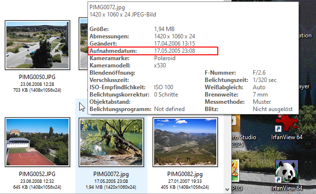

It also happens that there is no EXIF date even though other EXIF data is present, here shown in DOpus:

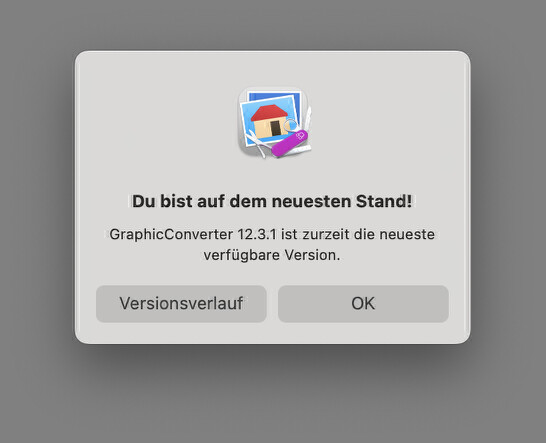

Guido,
Maybe it's the version.
I have Graphic Converter 11 and it definitely displays a date even if no EXIF DATE is present and I had selected EXIF date in preferences.
You probably have version 12. The user interface in your screenshots is different.

I'm glad Graphic Converter Version 12 does not display any date if there is NO EXIF date.
I don't think there is any point displaying a date under a Thumbnail if no one knows what field that date represents! But Leo disagrees.
Perhaps because of the complications mentioned above.

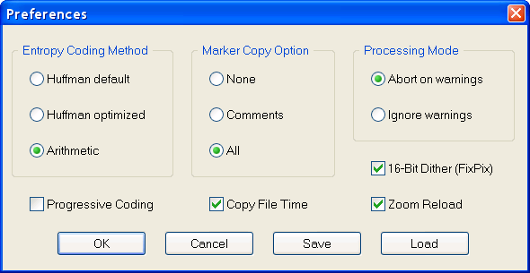

My Jpegcrop utility does this by default:
See the Jpegcrop Preferences and Options description:
Copy File Time
Many people prefer to keep not only all extra markers, but also the timestamp of the transformed file in the filesystem. So the default setting for this switch is on. In the off state the written file gets the creation timestamp as usual.
Unfortunately, the corresponding jpegtran commandline utility does not (yet) provide such option, because it requires a bit more effort for cross-platform use.
