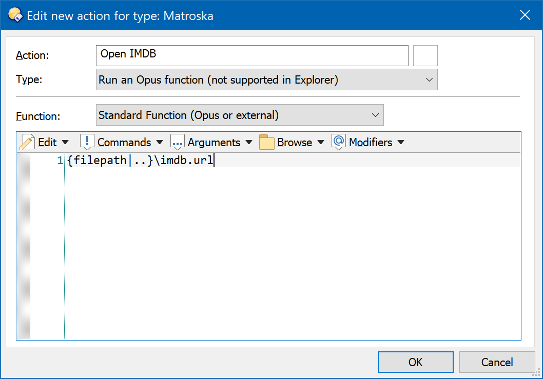

Just add this as a .MKV context menu item via Settings > File Types:
{filepath|..}\imdb.url

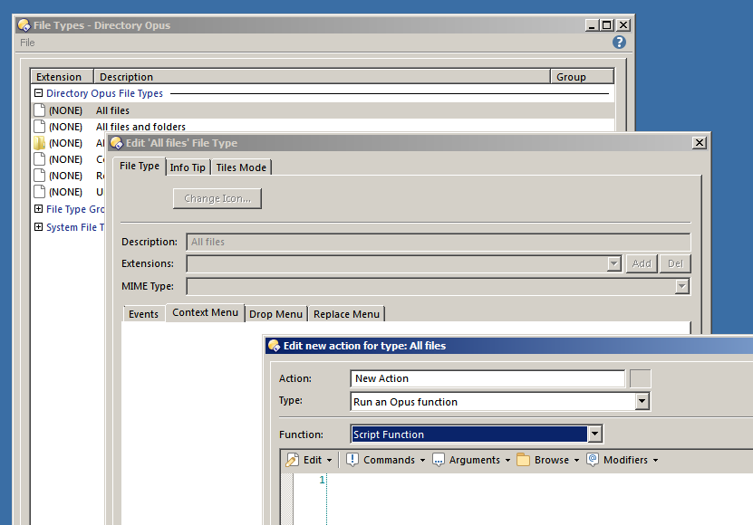

I have noticed that in the context menu when I hit Edit I don't get the Script Code tab that allows you to choose JScript or VBScript.
I think you have to move your script into a user command and insert this command as the action of your File Types context menu. You can reuse the user command in your regular button.
You don't have to use a user command.
Zolder, please show a screenshot of the context menu definition. We should be able to see what is wrong from there. My guess is it is not set to the right script language.
There is no option to select a script language in the File Types Context Menu.
Looks identical to the Standard function.
You use @script jscript at the top of the script there, after choosing Script Function from the dropdown.
Thank you. Now it works.
