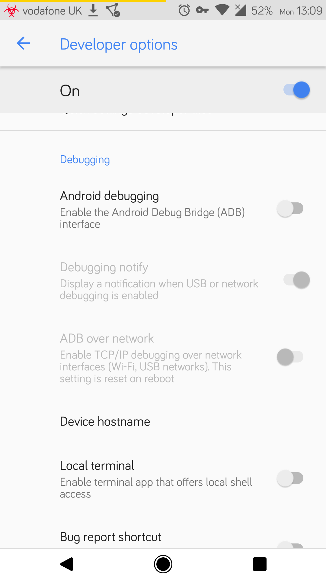

Another thing that can mess up MTP transfers is if you have the ADB interface enabled on the phone. I've found that turning this off really helps.

On my phone it's called USB debugging. I am a developer and therefore I need this enabled. I have no ADB setting.

If you have USB debugging enabled, then you have ADB enable - it's one and the same thing. I run a custom ROM too; LineageOS or currently, crDroid. I've had Opus running with ADB enabled but I find it tends to be a bit flakey, so I turn ADB off. I don't use Explorer for file transfers so can't really comment whether it's any better than Opus. It maybe that Opus' implementation of MTP is slightly different to Microsoft's. In my experience, GP Software tend to have a better grip on the various protocols and implementations than Microsoft does anyway.

With ADB/USB debugging turned off I don't have any problems with MTP on Opus. Agreed it's not the best for file transfers, but if you queue up files from different folders it runs just fine rather trying to force multiple file transfers
