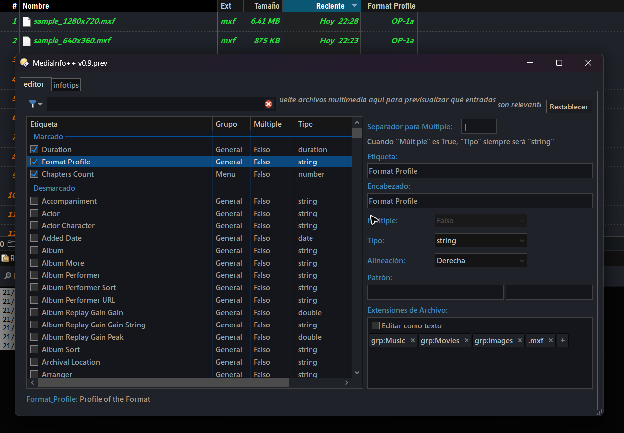

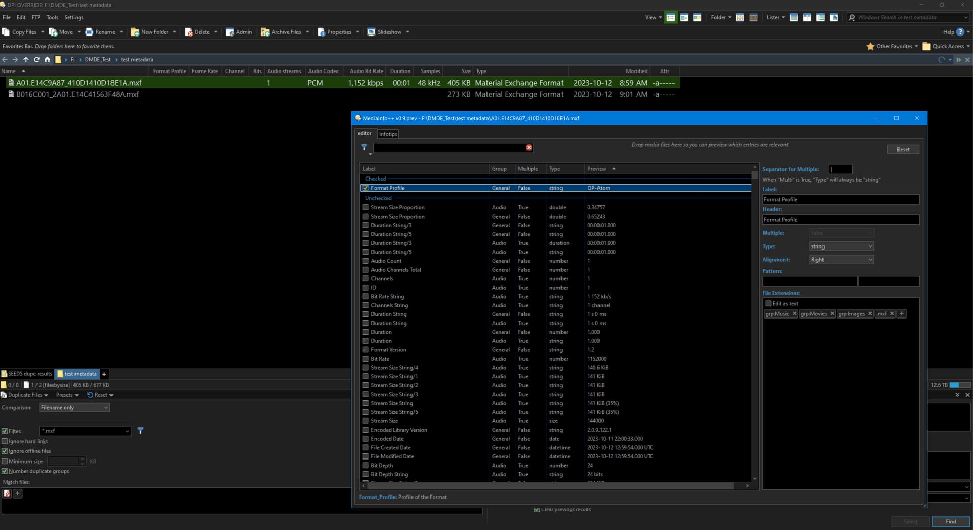

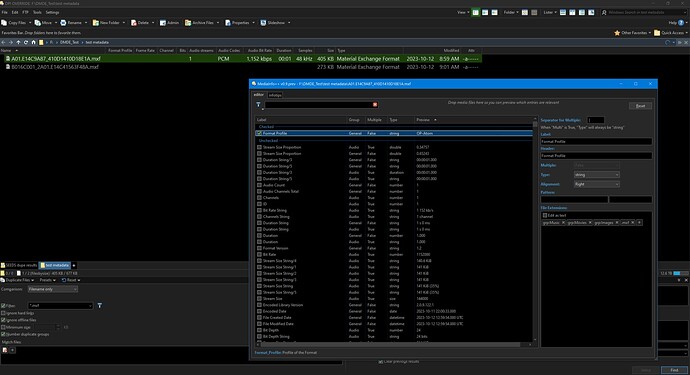

Trying to use this to verify mxf files for a Duplicate File comparison so I can sort by Format Profile and then select the file that is empty (corrupt) in this column but the column has stopped populating. Initially 309 out of 4853 duplicate groups had Format Profile values but upon restarting dopus no files appear to have values in this column.
The column logic appears correct - mxf is listed under extensions, and dragging these same files into the MediaInfo++ editor shows full field population. Any insight or diagnostic advice appreciated.
In the exts field, try using .mxf (with the dot) instead. I think I got that part wrong when I described it above. The correct would be "with the dot included."
Tried unchecking and re-adding just Format Profile when chaning mxf to .mxf didn't work. Still no go even with a smaller folder of two files.

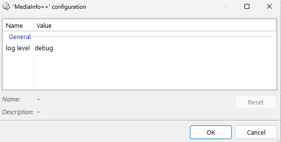

Set log level to debug in the script config and then open the script log and refresh the lister, then please post the log related to the script here.
FWIW, it's working here.
Also, please note that any changes you make won't take effect until you close the command's dialog and if the edited columns were already in use, refresh the lister.

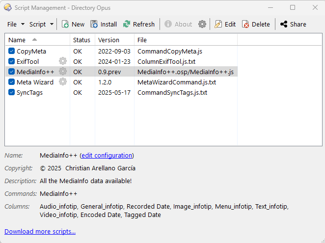

I installed, I selected columns, and then I added those columns to a folder format.
Now I want to select more columns, but I can't figure out how to open that dialog.
I can only open this:
Or this:
How do I re-open this:
Thank you.
MediaInfo++ CONFIG
Thanks, but I don't even know what to do with that!
Is there nothing here that will open it:
Put the command in a button.
Or type a > then MediaInfo++ CONFIG

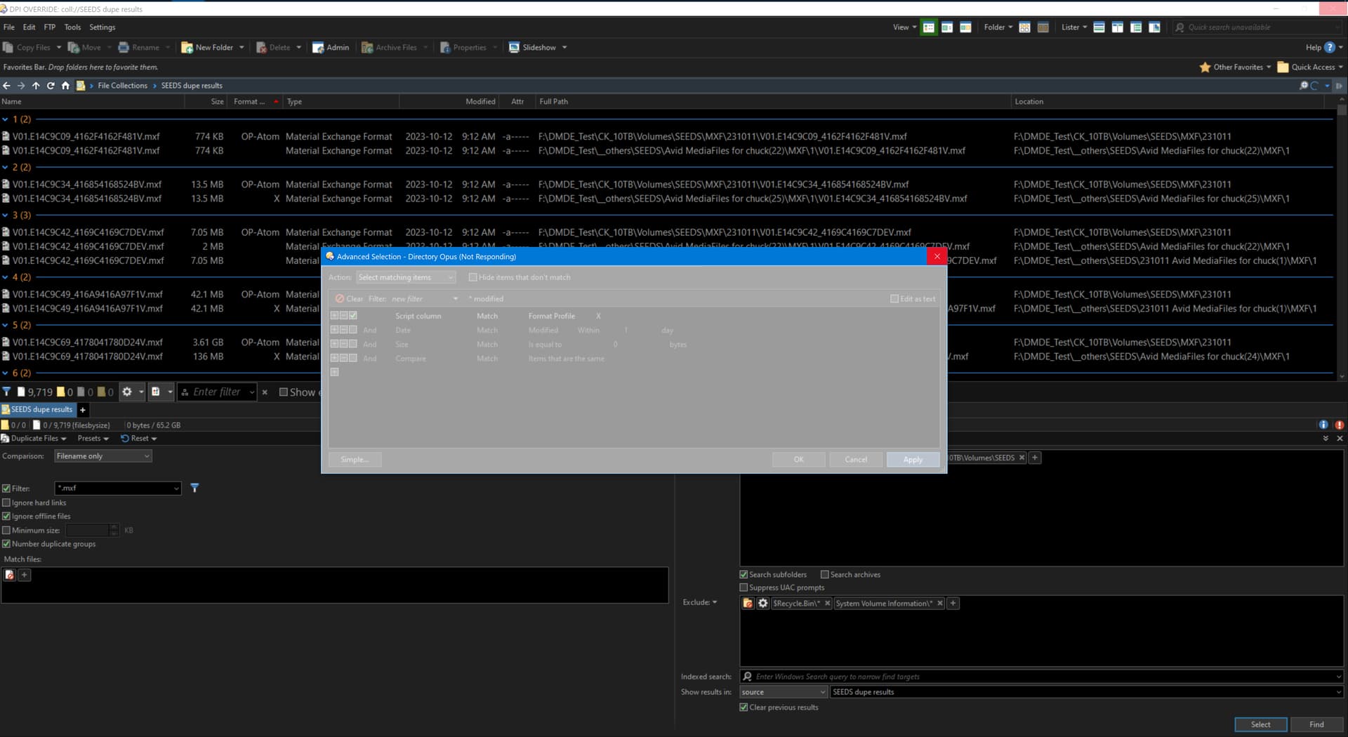

However, MediaInfo++ still stops scanning at around 309 duplicate groups.
I then used Advanced Selection to select rows where the Format Profile column shows "X", but Directory Opus became Not Responding. Is this because it's triggering MediaInfo++ to rescan all files in the result set rather than using the already-scanned "X" values?
Any advice on avoiding the rescan or ensuring values are cached before selection?

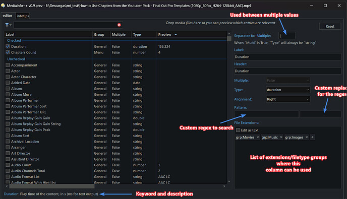

Please try this version, it has a cleaner log and some minor fixes in the configuration dialog.
