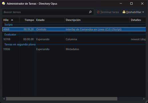

When trying to open one of these files that way, the script stops responding—and eventually DOpus does too—and you can't even kill the task from the new Opus Task Manager.
Since this plugin doesn't return anything when opening a file, there's no way to detect if/when this happens. According to this part, it's supposed to throw an error on failure, but it doesn't seem to apply here, not sure why.

Opus won't hang, but it'll start gobbling CPU and memory, you can't stop it—even from its own Task Manager—and eventually you have to completely exit from Opus.

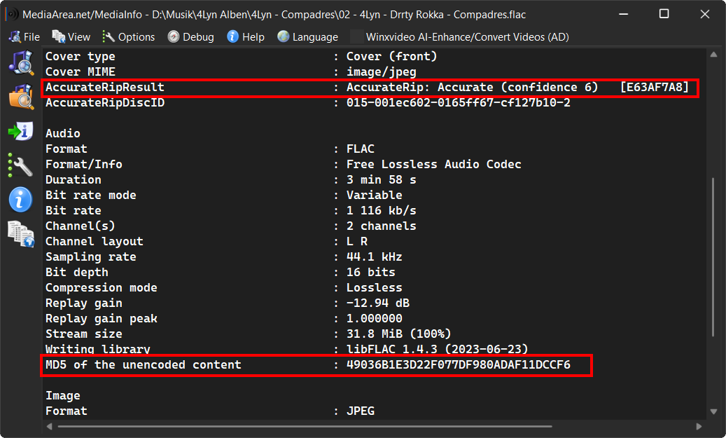

  1. Could you add "MD5 of the unencoded content " and "AccurateRipResult" into the list?

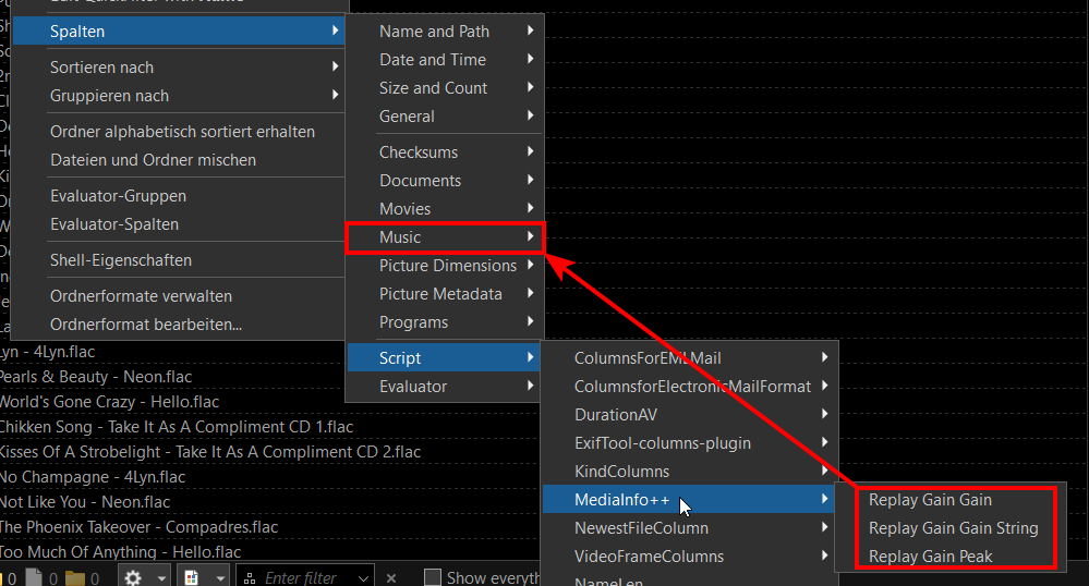

For custom categories, I can add an option for that too, although I can't find how to change that value for a column in the documentation.
