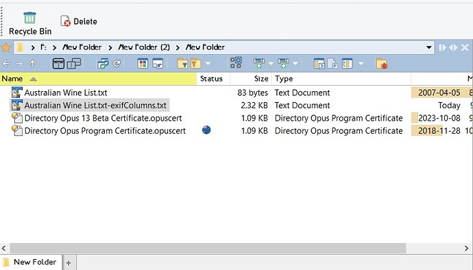

So here is a screen shot of a file selected for deletion and the recycle bin is empty.

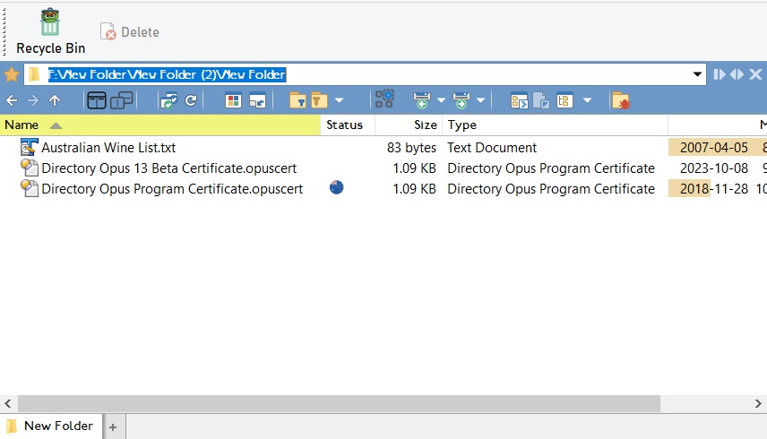

I delete the file.
I then get this screenshot.

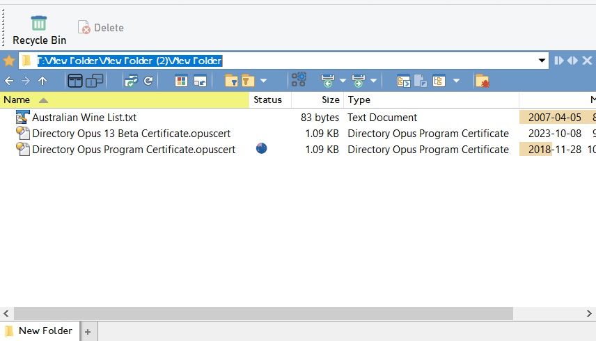

I then right click your button and I get this.

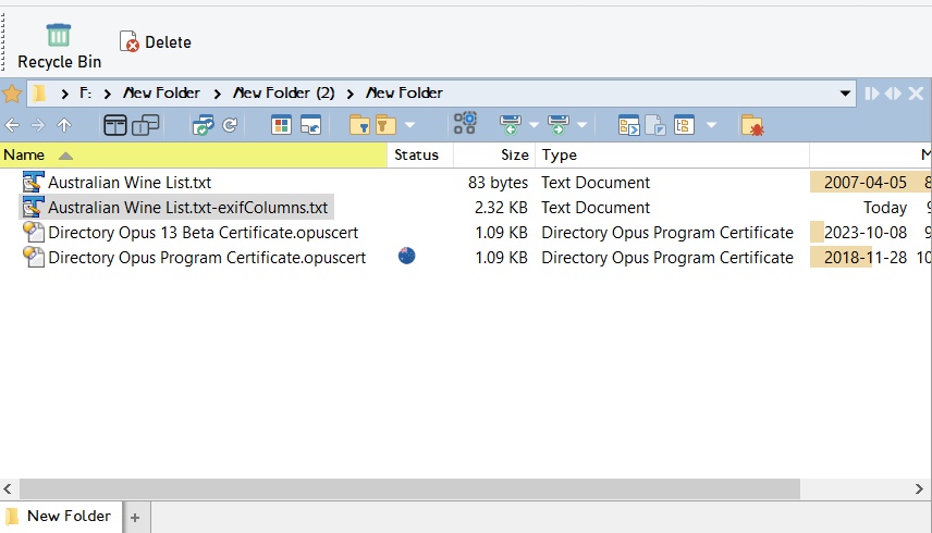

See that I have to click on a file before it will work but the secure wipe works.
I noticed while reviewing this vid that the other icons on that toolbar blink when I click a file.
That reveals the issue. But I've already made that vertical toolbar be a user toolbar, instead of a factory one. Tried out the toolbar settings too. Tried moving Oscar to other toolbars. When it was on the main top toolbar it worked the first time. Tried again and of course it was just a fluke. Oscar is just being a stubborn boii.
