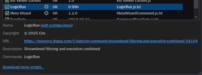

Alright, I updated to the latest LogicRun version.

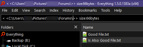

Paste this into Everything :
< <C:\Users\me\Downloads\Hardstyle\>> size:66bytes
Does it give you more than one result?

Hold up. I had an idea. I moved the files to another location and as I suspected it's because the downloads folder is a virtual folder (as far as I can tell). I got both items show up in another folder.

So I checked your original code and yes it does work but not in the downloads folder.

Everything does give the correct folder results. My 'Folders index' area was empty but that's because folders are already included in the NTFS index area. I tried adding my pictures folder and it warned me that it's already indexed. I did it anyway and got duplicate results. Removed it and it's back to normal.
The button wasn't working for folders that are 66 bytes each. I added a bunch of files into them and it started working when the sizes were in the kilobytes. And worked at about 1.2 megabytes. Then stopped working again at 2.66 megabytes.
