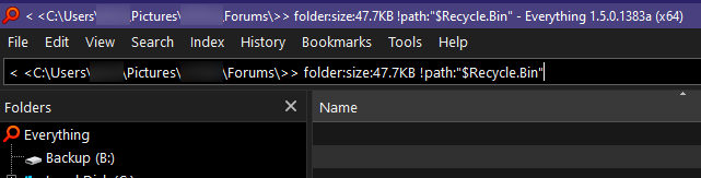

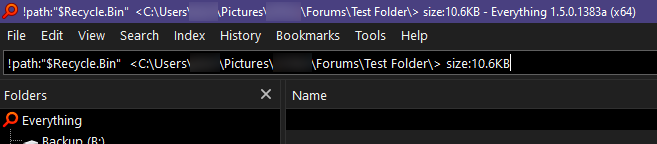

Then there’s definitely something off with your Everything config since it’s returning zero results (Query finished, results: 0). At least I can say that the command is working as expected :slightly_smiling_face:
Try pasting this search into the Everything window and upload a screenshot of the result:
< <C:\Users\me\Pictures\Pics\Forums\>> folder:size:47.7KB !path:"$Recycle.Bin"
BTW, thanks for the feedback—it’s greatly appreciated! This kind of input really helps iron out the details.
Oh, I thought I was the one bugging you.
No results.

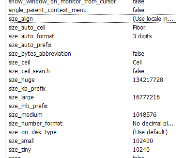

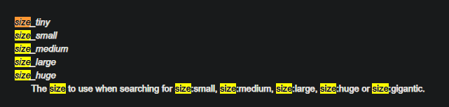

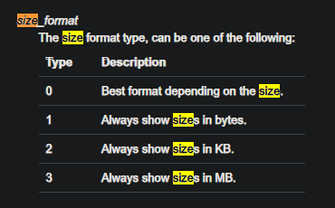

The advanced options has our answer.
The size rounds to the floor. Floor means the nearest lowest.
Since the size_tiny is 1024, that means anything smaller than 1MB rounds to 1MB, being the floor. So I'm not sure if I should mess with these options.
Not sure what Auto_Size means either. I'll look to see if this is in the manual.

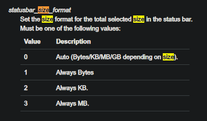

Auto Size
None of those options seem to have been changed from their defaults (changed values are highlighted in red).
On a side note, I think I’ve discovered an issue with retrieving folder sizes under certain conditions—that might be why comparisons fail. I’ll try to reproduce it and inform Jon/Leo about it.
Ya those options are at the default. I think it would explain why "retrieve sizes from Everything" results in incorrect sizes too. I'll have a look to see if I should change some things or just leave it as is.

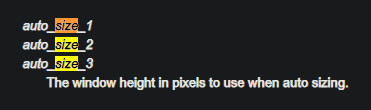

Alright, here's a "size" word search on the relevant document.
Size Auto is for the window.

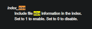

I'm pretty sure he got rid of these, just putting them in the main NTFS options, but didn't update the document. Either way they aren't there (in the advanced options).
Size Fold Index
This isn't there either. I assume it's 0 by default (best format), because the measurement does change based on the size.
I don't think this is relevant. It's just the Everything status bar, showing on the bottom right.
"Size Tiny" is just an alias for searching.

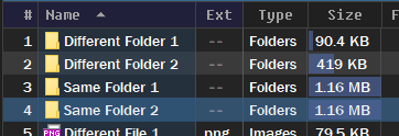

Ok. I set up a test folder with a bunch of dedicated test subjects.
Left clicking on a larger file works fine. Shift + click works fine too.

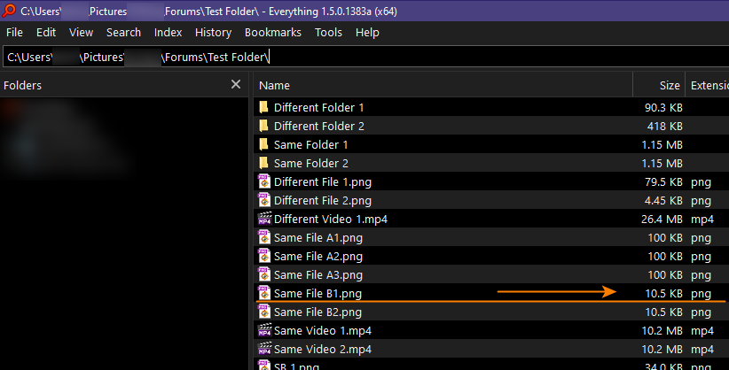

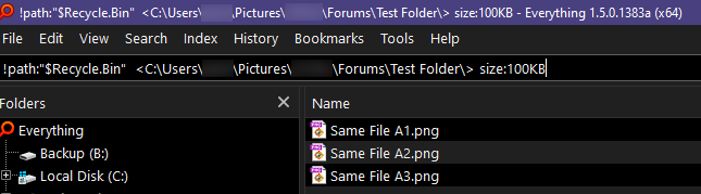

The Everything result is good. All three appear:
But left clicking on this file (left clicking the button while that file is selected)

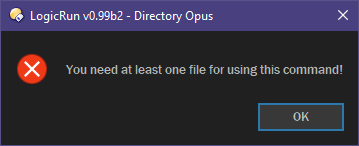

Need One File Files
results in trouble.
The log for when that happens:
 03-May-25 10:07:PM LogicRun:  INFO    => === COMMAND BEGIN ===
 03-May-25 10:07:PM LogicRun:  DEBUG   => cmdline              : LogicRun IN "C:\Users\hi\Pictures\hi there\Forums\Test Folder\" GETPROPS USEEVERYTHING size:$(sizeautoEV)$
 03-May-25 10:07:PM LogicRun:  DEBUG   => COMMANDS             : true
 03-May-25 10:07:PM LogicRun:  DEBUG   => USEEVERYTHING        : size:$(sizeautoEV)$
 03-May-25 10:07:PM LogicRun:  DEBUG   => FILTER               : false
 03-May-25 10:07:PM LogicRun:  DEBUG   => FILTERDEF            : false
 03-May-25 10:07:PM LogicRun:  INFO    => Expanding filter...
 03-May-25 10:07:PM LogicRun:  DEBUG   =>  => Getting values for "sizeautoEV" for 1 items...
 03-May-25 10:07:PM LogicRun:  INFO    => Getting files using Everything...
 03-May-25 10:07:PM LogicRun:  DEBUG   => ==> EV is running:true; autorun:false
 03-May-25 10:07:PM LogicRun:  DEBUG   => ==> Waiting for EV database to be loaded: 1
 03-May-25 10:07:PM LogicRun:  DEBUG   => => file : C:\Users\hi\Pictures\hi there\Forums\Test Folder\
 03-May-25 10:07:PM LogicRun:  DEBUG   => QUERY                : !path:"$Recycle.Bin"  <C:\Users\hi\Pictures\hi there\Forums\Test Folder\> size:10.6KB
 03-May-25 10:07:PM LogicRun:  DEBUG   => ==> Query finished. Results=0
 03-May-25 10:07:PM LogicRun:  INFO    => ITEMS TO FILTER      : 0
 03-May-25 10:07:PM LogicRun:  WARNING => You need at least one file for using this command!
 03-May-25 10:07:PM LogicRun:  INFO    => === COMMAND END ===
Everything result is none:
Same happened when this folder was selected:
Same Folder Error
Using it with folders doesn't work at all.
Left click or Ctrl + click. The same error happens. The log is probably the same; I'll post it if you want. I'm screwing with my user folder paths because with AI scraping the whole web I can't trust a damn thing anymore.

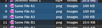

Can you find the trouble file in Everything and show me the size column value?
Ah yes, it's 0.1kb different than in Dopus.
The problem folder is also 0.1MB different than Dopus.
The VoidTools dev reply did mention I can choose the number of digits for sizes. Not sure if that's involved here.
Mmm I'd never really considered before that the two might round out the size differently.
It might be interesting to ask him (void) why there's such a difference.
