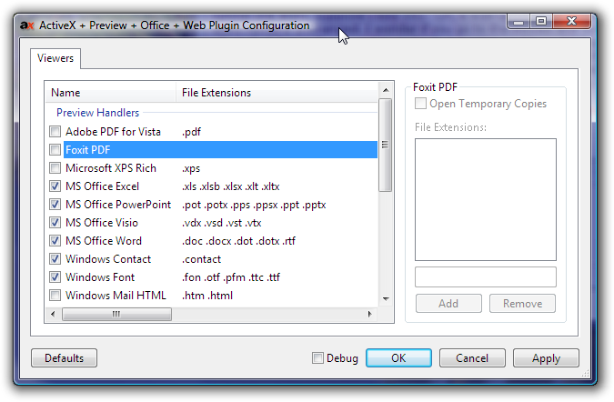

If you have FoxIt installed then it will be used by the Opus viewer pane automatically, provided it's installed to work with Internet Explorer. (That usually just means if you have another PDF viewer that works in IE then you need to have installed FoxIt last so that it overwrites the other viewer's settings.)
If you install the FoxIt preview handler (which itself requires FoxIt) then Opus will use that instead; however, that actually gives you a slightly worse viewer than the default FoxIt one.
If you want to install the preview handler for Outlook 2007 or Explorer's preview panel while using the normal viewer in Opus then you can do that. Configure the ActiveX plugin in Opus and clear the FoxIt checkbox under the Preview Handlers heading. (If there's no checkbox then the preview handler isn't installed.) The ActiveX plugin then drops down to IE which in turn will invoke the normal FoxIt viewer.

Oh, you're probably right in that case. I thought the FoxIt Preview Handler hooked into the standalone FoxIt viewer DLLs (like the Internet Explorer viewer does) but maybe the preview handler comes with its own copy of the DLLs.
It's about a year since I looked at it so my memory is probably faulty. Looking at the preview handler's webpage there's no mention of downloading FoxIt so, yeah, it's gotta be standalone.
