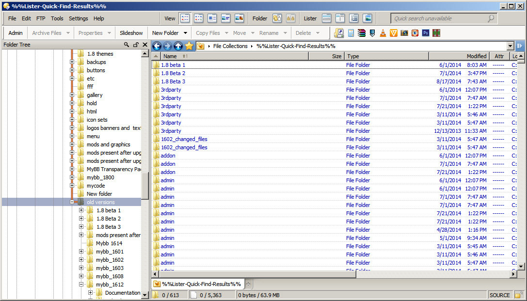

Could you post a screenshot showing the Lister in the "unavailable" state?
See attached. It starts out being open, and if I don't type fast enough it changes to the state you see in the photo.
This happens while searching normal folders on my local hard disk that I was able to search before.
Please show the whole Lister.
Here it is.

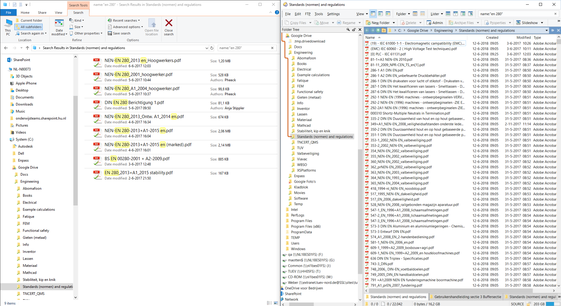

Can we see a screenshot of the whole window when the problem is happening?
Above pictures shows Explorer and Dopus with the same search phrases.
Explorer shows a list of ~10 files (of ~22.000), Dopus doesn't respond to the command at all, no feedback... nothing.
Have you tried reinstalling Opus over the top of itself (don't uninstall first, just run the installer again), and then rebooting?
That did the trick! It works again. It might be worthwhile to know why it went broken...
