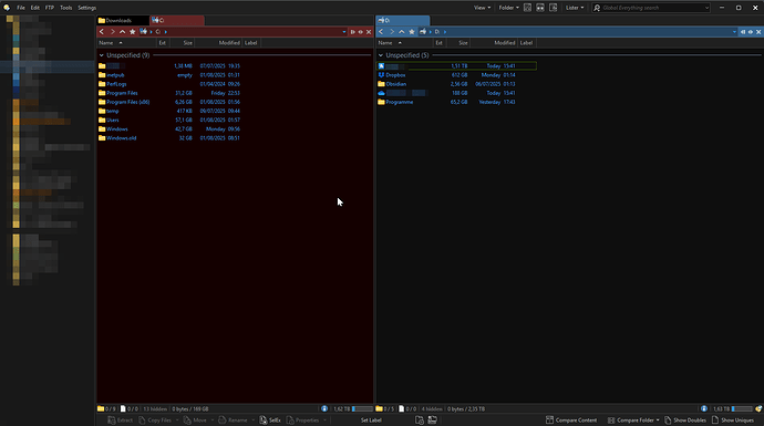

Here's a screenshot from HWiNFO in the meantime:
CPU
Interestingly, the chipset has the words "Low-Power" and I don't know why, or if it's even relevant. The CPU minimum looks low too. When I'm resizing, the CPU stays at 4 GHz+, so you'd think it would have enough juice. My Windows Power Options also have Minimum processor state set to 100%. Maybe the BIOS settings are overriding this, as the CPU clock does fluctuate between ~3-4 GHz.
Edit: And Ryzen Master:
