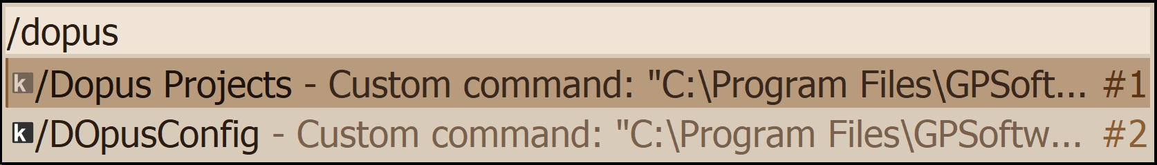

Keypirinha Version
When loading your alias configs, calls a python script which automatically ports your aliases into the Keypirinha launcher, so you can open an aliased directory from anywhere (opens dopus at target location).
You will need to check the path for everything, including the location of your keypirinha install.
Keypirinha version of Load Alias.bat

            "[custom_commands]",
            "# Type / in Keypirinha to bring DOpus alias launchers to the top.",
            "item_label = /{cmd_name}",
            "history_keep = cmd",
            "auto_terminal = no",

New version automatically imports aliases into Keypirinha when running LoadAlias.bat or SaveAlias.bat
