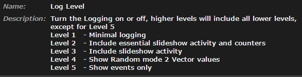

As for debugging
Logging is getting turned off after a DO restart.
