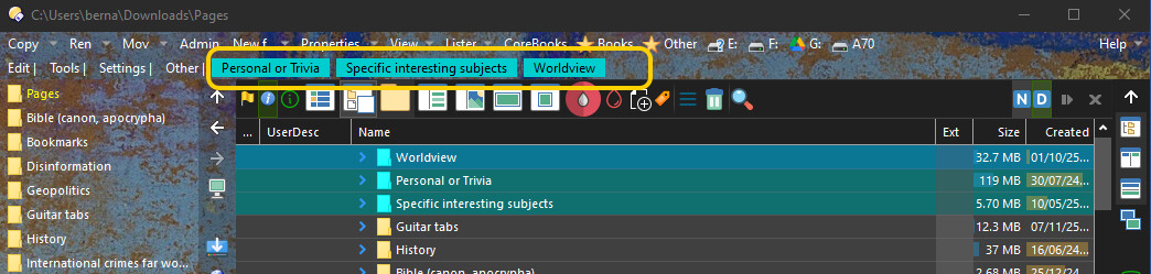

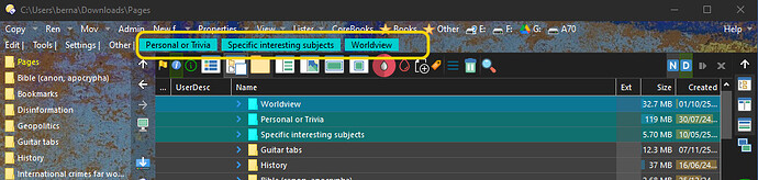

For me, this simple script does exactly the few simple things I needed (the part indicated in yellow is the button part - and you can see the pinned folders in the lister too).
For others, this may perhaps be the so far simplest implementation of the new "script-generated buttons" feature.
