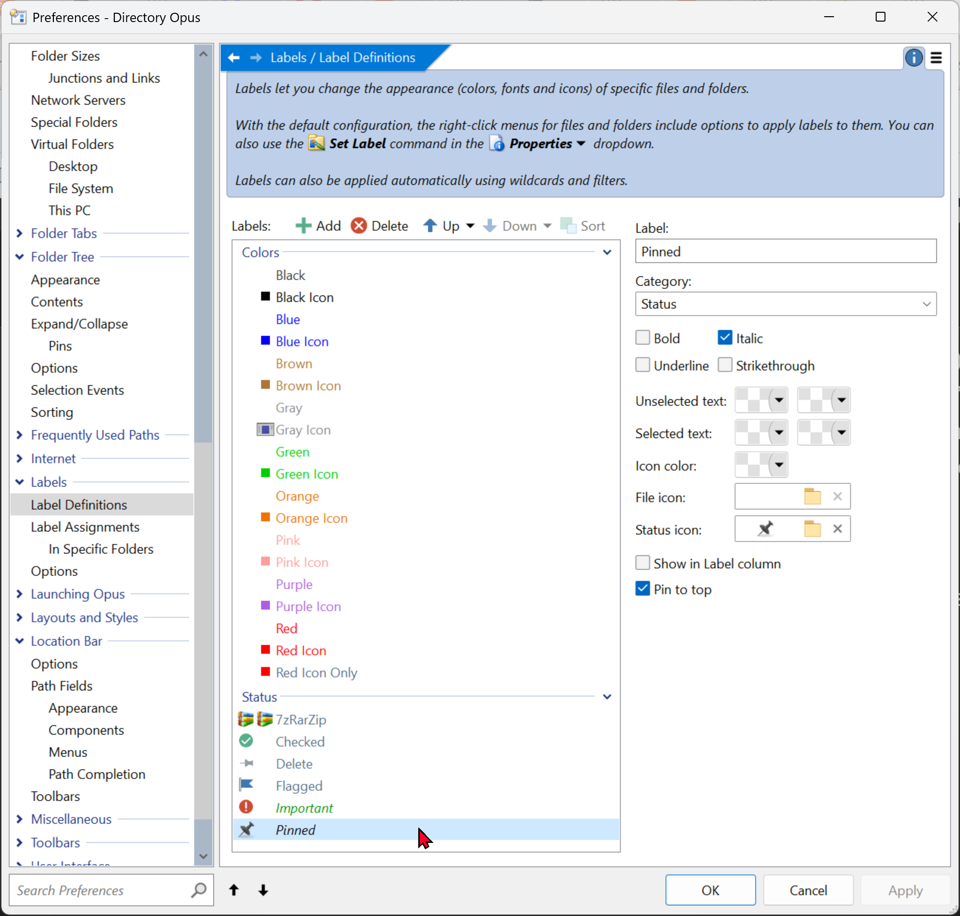

When it comes to pinned folders (not in the treeview but in the folder panel) Opus offers the possibility to give a folder a label that has the attribute “Pin to top” set. I’m using this possibility ever since it was introduced. But this option really means “Pin to top of list”, because a pinned folder still disappears from sight once you scroll down.
Could there be another option “Pin to view”, which would keep the folder in sight even whien scrolling down? Or is there already a way to achieve this in one way or another? (And I mean other than using a split view where I can keep the folder(s) in sight in the top window - I’ve tried this workaround but it is not very satisfying).

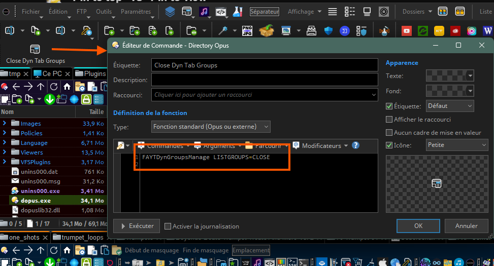

Here's a toolbar in edit mode:
It has only one button and it's using a custom command from the script linked above.
That script is made to open tab groups (from the ones you can define in the Preferences) and add/remove them from your current lister.
The lister I used it here has a few of those groups opened, so the LISTGROUP=CLOSE option from my command will generate one button for each group that has been previously opened with the appropriate command.

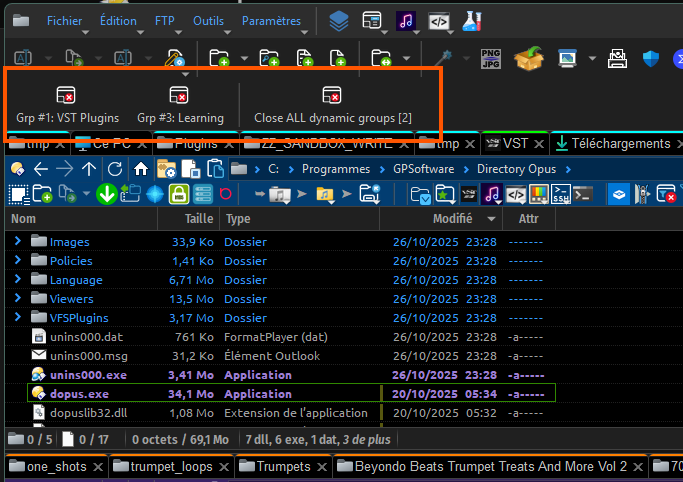

This is how it looks when quitting customize mode:
The different buttons are generated by the script depending on what groups have been previously added.
The logic would be the same for you except you'll need to refresh the list of buttons upon entering a new folder (and associate the action/command triggered by the button accordingly).
