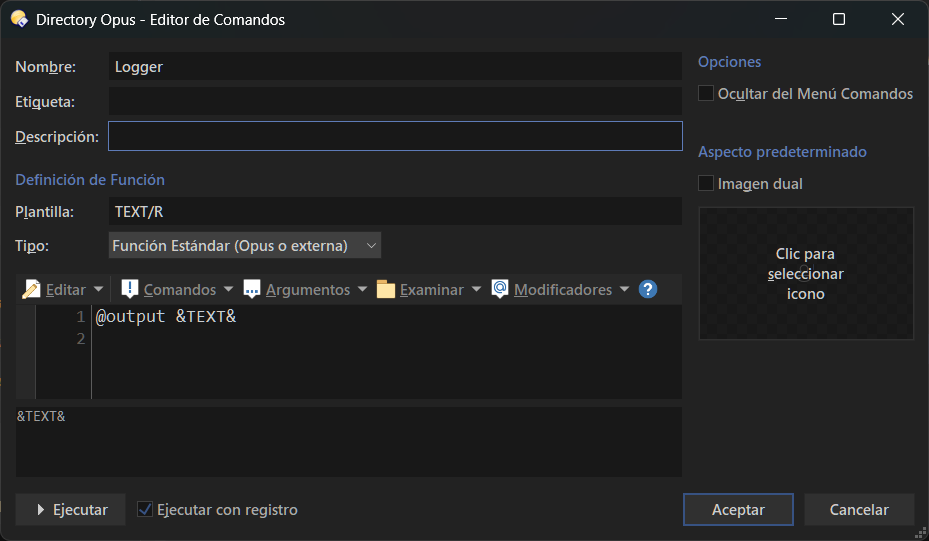

You can't use @ modifiers with dopusrt directly.
Instead, create a User Command (Customize -> Commands, User category) and then run that via dopusrt.
In general, you can run multiple commands via dopusrt by running dopusrt multiple times, once per command. But since you cannot run the @ modifiers from dopusrt directly that won't help here. (Even if you could it wouldn't be useful: The @confirm would cancel the first dopusrt command (which was just the @confirm itself) and then your batch file or whatever would run another command via dopusrt, independently of the @confirm.)
Alternatively, create a button normally, then drag it to your desktop. That will create a .dcf file which you can double-click to run the button.
You can also launch .dcf files from batch scripts using the "start" command.
