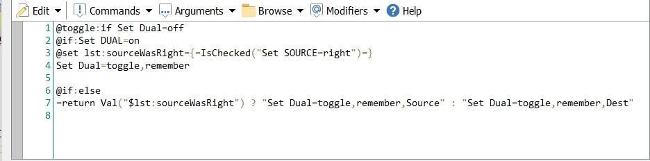

I thought the same thing so I wrote the scripts below awhile back. It'll remember the left/right (as you pointed out) plus the divider position.
When the script recalls the divider position it'll open with the seperator in the center then it will adjust the position. In other words you will see a flicker. That's because there is no way to open dual display with predefined size. Two seperate commands need to run, thus the flicker. Same goes with the SWAP command you may also see a flicker when the SWAP occurs (noticing the flicker depends on how many tabs are being opened). But, at least it's done automagically. =]
EDIT: made a change so that the Lister variable dualSize only saves when divider is not centered.
There's two variations of the script.
Toggle Destination: Dual Toggle - Dest.dcf (1.9 KB)
Alternate: When clicked twice (somewhat slowly) will alternate between src/dst for max view. Dual Toggle - Alternate.dcf (1.9 KB)

After the 13.13.1 fix, a small modification to @lxp's original solution will keep Source/Dest remembered properly.
