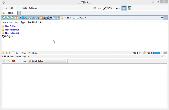

Now this morning, after some coffee I got into same meaningless testing as yesterday - all the things you just told me to do, and I have done yesterday numerous times - with no results.
Then something really strange happened. By share accident. Please take a look:
Notice:
  1. Nothing happens, when I add the columns - not even a peep, while there should be console output!
  2. After addinf the columns, I refresh the folder using F5 (hard to see in this gif) - nothing happens.
  3. Then I use ScriptWizard button to go to the scripts folder
  4. And then I use the Back button - and the script suddenly works... Console output finally shows that it is "alive" at least :smile:
I mean wtf? :confounded:
What the hell is happening here? :slight_smile:

That script v1.07 worked on my pc. Do you have multiple scripts with the same script name in the addins folder? Multiple versions perhaps, some older test ones and a newer one?
Maybe its loading an old script or getting confused between scripts?
The two empty columns are not unexpected when you are doing dev, when you save the script the columns might need to be removed and re-added.
Confirm you don't have multiple versions of the same script in the addins folder, Remove and re add those columns. Else I'm kinda stumped, sorry mate.
Do other custom columns work, from a known working script.
@wowbagger thank you so much for your patience and help.
I am an idiot.
If you look at my last screenshot, you actually may see the problem :smile:
And it's so stupid, I'm really embarrassed to admit...
The view was in list mode not details, notice how none of the columns show anything :blush:
I was so frustrated with script not working at all, even when I simplified it to the minimum, and it worked - I didn't notice that the lister was in List mode, my favorite and default mode.
I'm really sorry for wasting your time on my last post :slight_smile:
haha, nice one. Thanks for sharing mate.
:wink:
