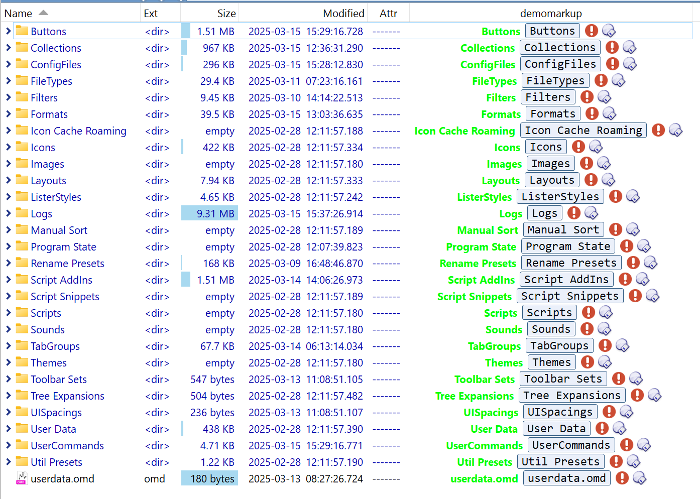

Here you go:
XML
<?xml version="1.0"?>
<evalcolumn align="2" attrrefresh="no" autorefresh="no" customgrouping="no" foldertype="all" keyword="demomarkup" maxstars="5" namerefresh="no" nocache="no" reversesort="no" supportmarkup="yes" title="demomarkup" type="0">operation == "markup" ? "<#00ff00><b>" + name + "</b> <kbd>" + name + "</kbd> <%error> <%bulb:3>" : name</evalcolumn>
Hmm. So it repeats the name from the name column twice in different styles, and maybe adds some status icons? Maybe someone would care to make a tutorial video about the evaluator columns? I'm sure it's an awesome function, once you know, what it can do.
