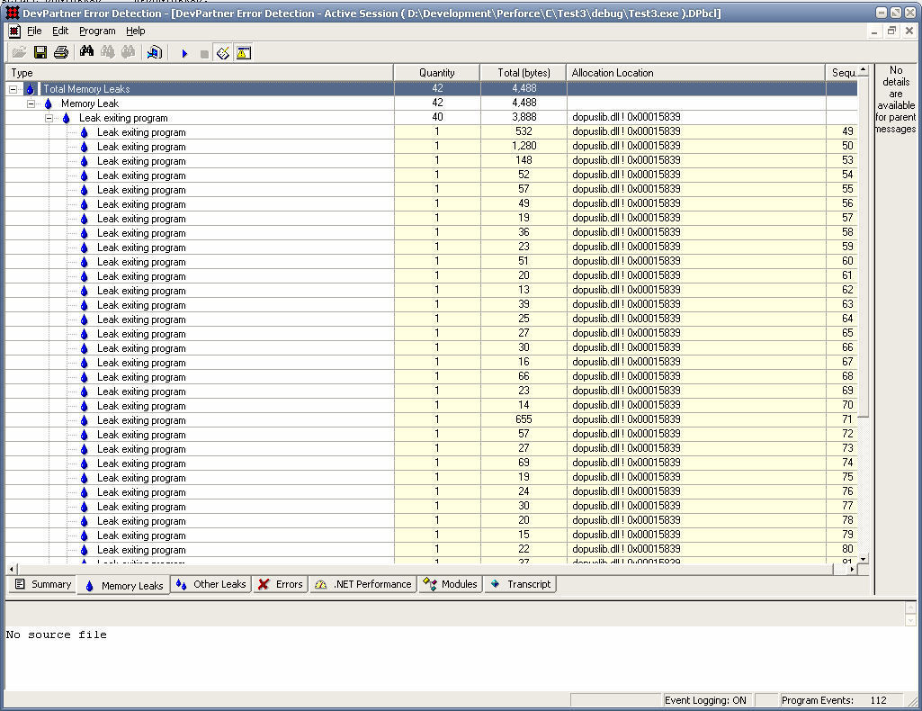

I used vs2005's new project wizard to create a default Windows application, no MFC/ATL/etc and from the screenshot you can see what I got when the app exited (from file/exit in the menu).
Also here's what I got in VS when I ran it:

The program '[13676] Test3.exe: Native' has exited with code 0 (0x0).
So I can't see how BC can miss something since it loads the program directly in it's own debugging session therefore it traps all LoadLibrary's, etc.
They might be real leaks, and I haven't used BC in years so it might work differently now, but when I used it last it hooked into Visual Studio's debugger and it only started hooking allocations at a certain point early in the program (but potentially after some DLLs and/or static data was initialised) and stopped late in the program (but potentially before some DLLs had been freed and static destructors run). Or something like that...
But, either way, it looks like there's something that needs investigating in terms of are those false alarms or real leaks, and why is dopuslib.dll sometimes being loaded into unrelated processes in the first place?
I'm at home now and tried running a C++ console app as well as an MFC app under the VS2003 debugger and I don't see dopuslib.dll loaded. But I have seen it in the past. I can't think of a relevant setting or anything to try which might trigger it... It's weird.
If you have the file collections icon on the desktop and your program enumerates the desktop folder then the dll could end up being loaded. Similarly if you are doing anything with context menus and the Opus zip context menu is enabled. There are probably some other cases that could cause it to be loaded but I can't think of any off-hand.
When I was trying yesterday I had a test version of Opus on both machines which meant the Desktop double-click was broken (because I hadn't restarted Explorer.exe so it was still using the old version of Opus).
Having rebooted today, I see dopuslib.dll is loaded again when I debug a program. It happens the first time I move the mouse over the program's window.
But if I turn off Desktop double-click in Preferences then dopuslib.dll is no longer loaded into programs I'm debugging. So there's your way to turn it off.
