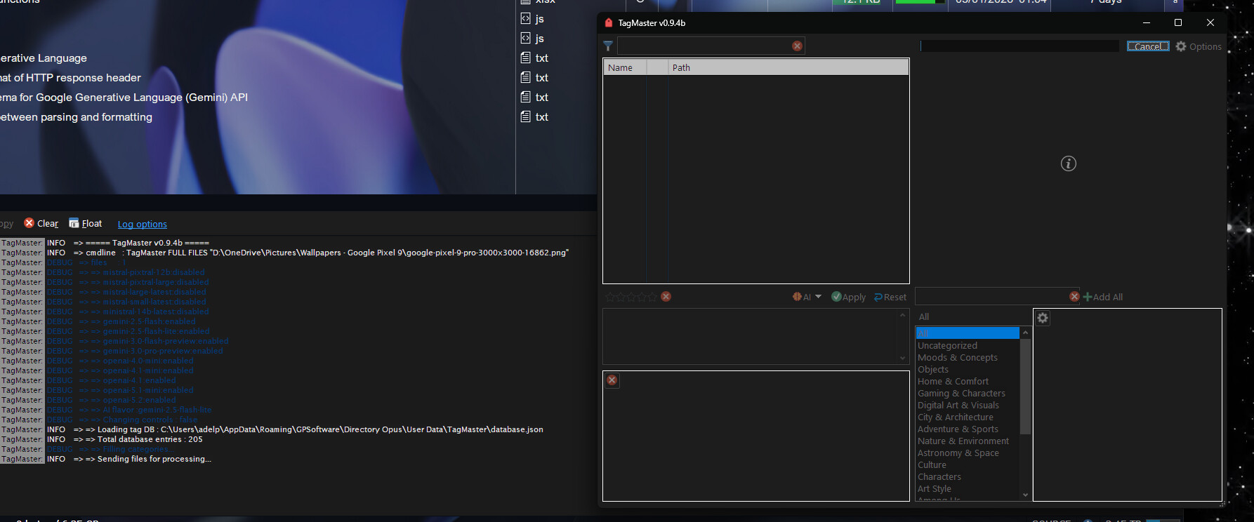

hmmm - TagMaster not showing anything now, no matter how many presses.
The first time it was sent something called ConfigFiles instead of the pathname from clip
and subsequent times I get this
correct pathname but no image

It looks like for some reason the helper goes wrong (very rare) and crash, so the dialog thinks the helper is still running when it's not. Try restarting Opus, that should clear all variables.
Also keep an eye on what you're doing when the helper crash. It should show an error icon in the status bar, since it would be an uncaught error.

here is ss of debug command
here is ss of @output clip
the 2 files are not the same, the clip is accurate.

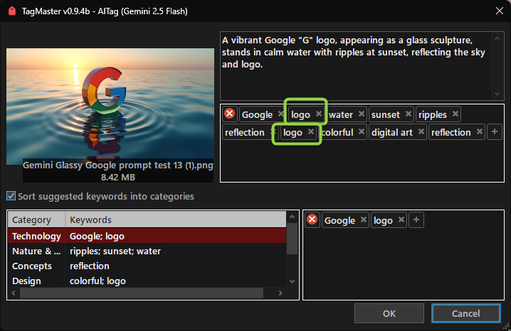

duplicate tags.
Also, some of my images already have descriptions (prompts and settings) that I don't want overwritten. The current solution - copy the original description, scrape tags & new description, paste old description back - is cumbersome. Can you put an option (checkbox or setting) to not scrape description ?
Did you add the duplicate manually? To be honest, I don't think I ever tried that. Those controls have a property called "avoid duplicates". I always figured it was used to prevent these kinds of cases. Manual cleaning will then be necessary. Thank you for noticing. But fwiw, the dupe won't be added, due to the type of object being used. So the problem would only be visual.
I don't think so, since the purpose of using autotag is to set (which means replace the current values) tags and descriptions. The same applies to tags.
Perhaps an option to do only one of the two, although we'll have to think about where to put that option, since version 0.9.5 changes that dialog a lot.
I'd like to hear about other use cases.
I think that if you erase the auto-description value, then the current one is not replaced.

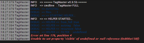

got this error message on first use with a selected image (png)
same error with subsequent images
Thanks. Try the latest version. (0.9.6b)
It was an issue when starting the non-ai version :melting_face:
Note that some arguments have changed since 0.9.5, I'll update the README.
Many thanks, working now :slight_smile:
