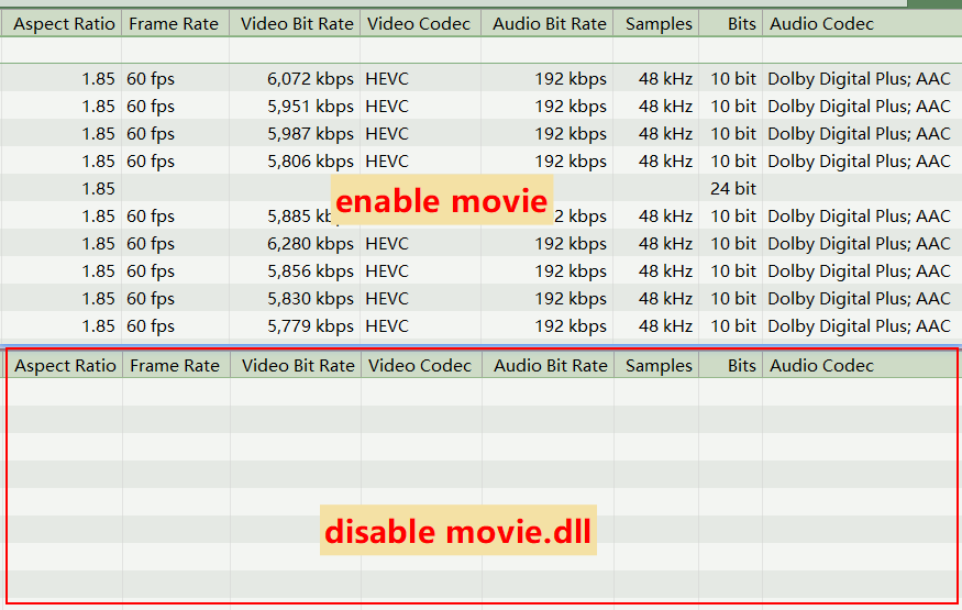

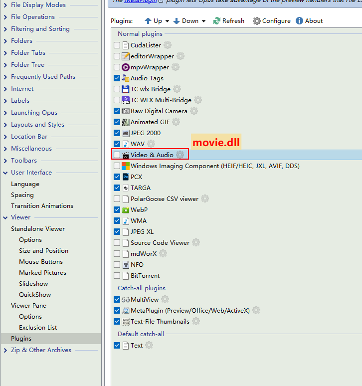

As I know, "Set CONTENTFORMAT Movies" show video metadata columns,and the metadata values are obtained through the viewer plugin movie.dll,
If we disable movie.dll, all video metadata columns are empty.
So, there must be a way to obtain metadata through a viewer plugin dll.

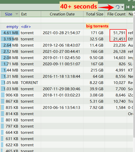

Using Jscript in DOpus, it takes 40+s to show all columns values (some big torrents),
But using TCTorrent.wlx in TC, It was read almost in 1 second.
The speed difference between the two is too significant. :worried:
Is the speed difference due to the language or what the different code is doing?

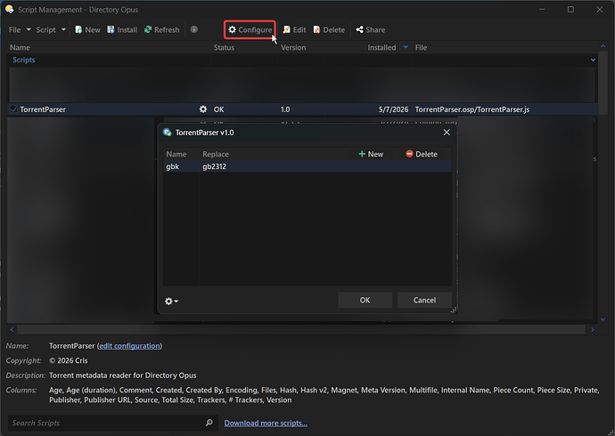

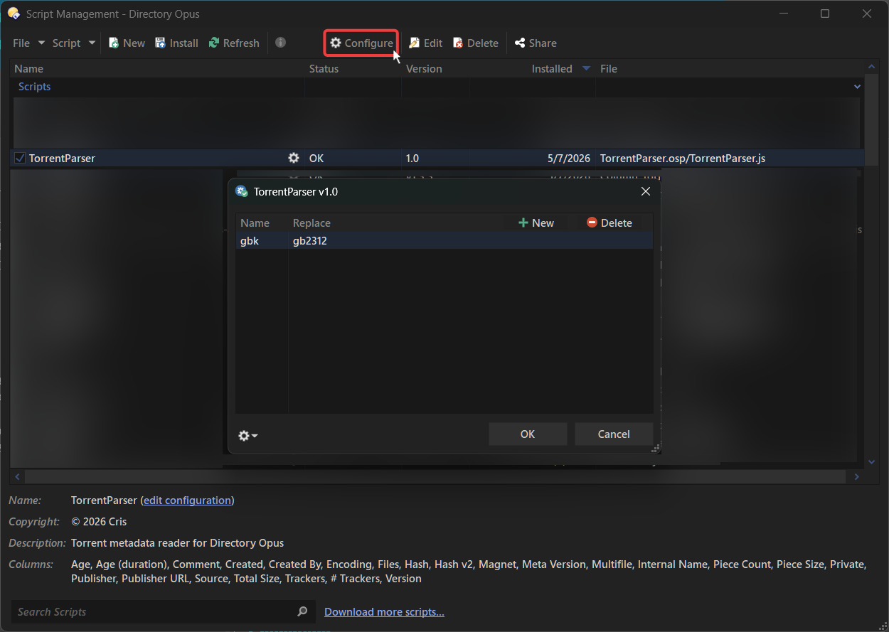

I noticed that some of your examples declare the encoding as "GBK". However, you can't use that directly with StringTools.Decode(). I also didn't want to hardcode mappings because that could easily become an endless task. So instead, I added an option that lets users define their own encoding/code page mappings whenever they run into a specific one. You can access it via Configure in the Script Management window.
I don't think I can make it any faster, to be honest, especially for v2 torrents, which take the longest to parse. But I think the current performance is pretty decent, almost the limit of what JScript can do, IMHO.
