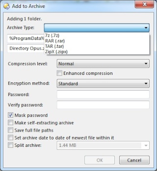

Select a directory and then use the Archive Files button on the toolbar, then click OK.
I used the Archive Files button and chose to test with 3 out of 4 of the available options (7z, rar, zipx, except tar). All zipping were done without errors.
The default Zip mode is the one to try, as that's what the Backup function uses. The other modes, including ZipX, all go via a separate plugin rather than the internal Zip code.

It's because the function Copy ADDTOARCHIVE HERE is greyed out unless I chose one of the compression option (Archive type) or only if I choose the option "Make self-extracting archive":
Thus, this is the reason why the first time you asked for the zipped files, I wrote to you that I used the options to zip with 7z, rar and zipx. Until you confirmed that the function Copy ADDTOARCHIVE is the one to use and I noticed and chose the self-extracting archive option, I was able to create the files you asked for. Therefore, you see, I didn't have any other options left because the remaining options can't clear out the greyed-out OK allowing me to do the zipping.
