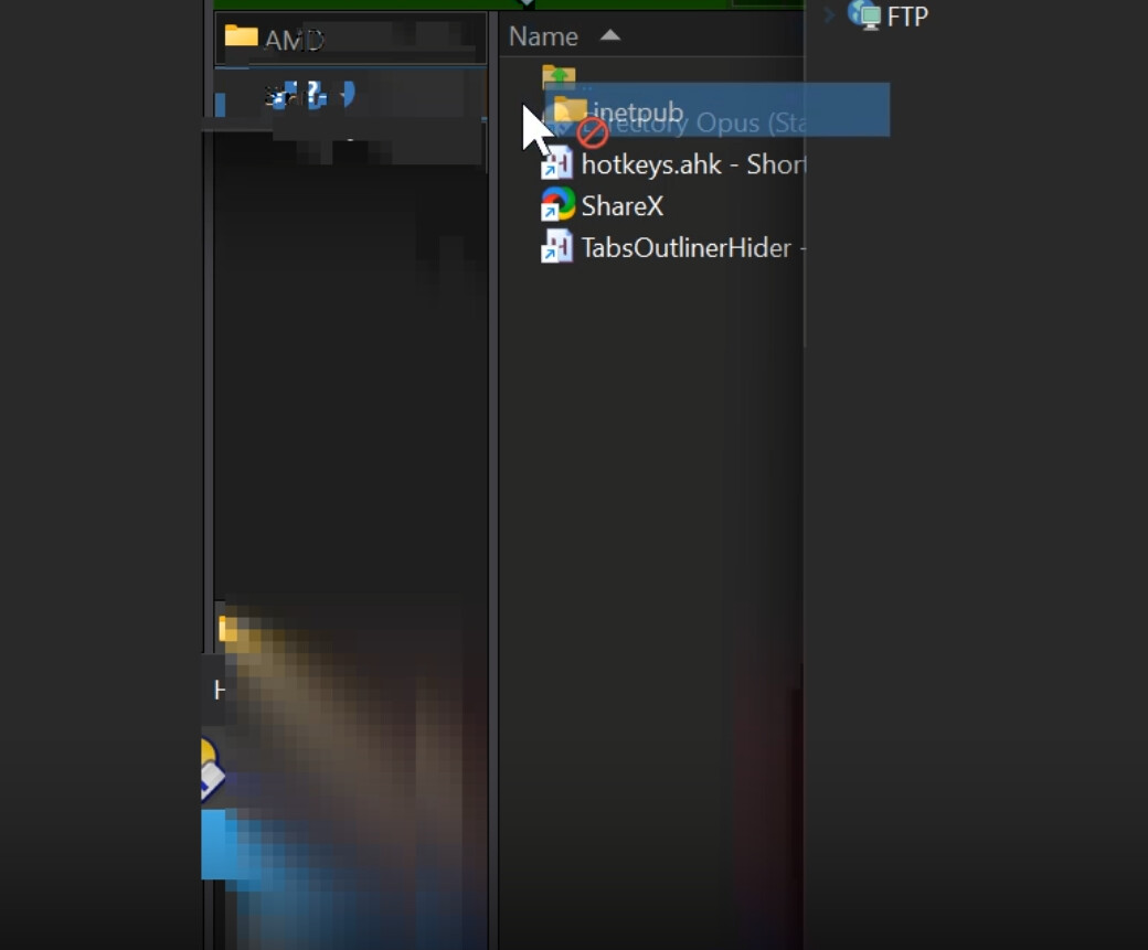

I'm having this same problem in 13.15
I am using a mixed-DPI system, but even after disconnecting my other monitor and restarting Dopus, I still can't reorder the tabs (it just moves it into a new window, like OP).
This may solve it:
All the compatibility settings are off. This is a fresh windows install. I've tried uninstalling, installing checking all the compatibility settings are off, reset to factory, it still doesn't work.
What are your monitor settings in Windows? (Resolution, scaling % and positions relative to each other.)
Can you record a video of what happens?
Rebooted with only 1 monitor, 2560x1600, 150%. Windows 24H2
Notice I can easily put the tab back in there, but can't re-order them.
  1. It's worth checking the compatibility settings under "Change settings for all users" at the bottom of the dialog as well.
  2. Around 10 secs into the video, is the visuals in the bottom left corner what you see on-screen or is that just an artifact of the capture software?
    That's very strange if it's visible on screen.
  3. If you use File > Exit Directory Opus, then restart Opus, is the problem still there?
  4. One possible cause of the problem is tools that put a transparent window over the top of the desktop, which always make it look to Opus like the tab is being dragged to another window (since the other tool's window is covering literally everything, even if it's not visible). We saw that with a tool that displays information in overlays, for example. If anything like that is installed, try disabling it to see if it's involved.
