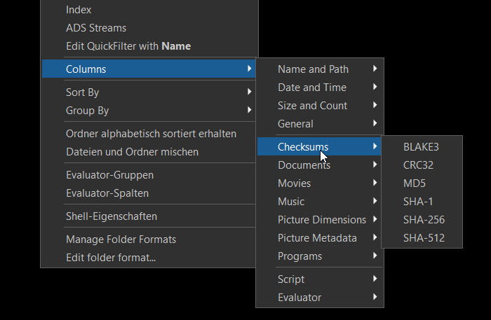

You do not need this script if you're using Directory Opus 13 or above, as there are now built-in columns for SHA-256 and SHA-512
