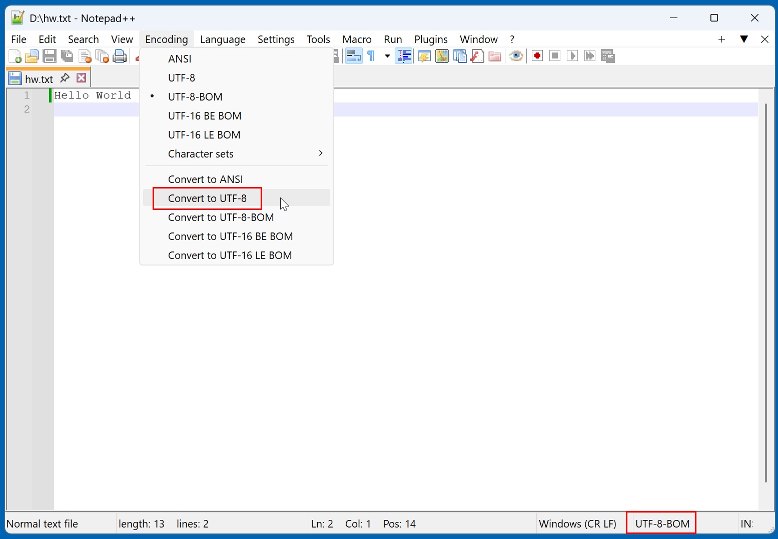

If you have only a few documents to convert, using a tool like Notepad++ might be easier:
Thank you. I already tried that.
