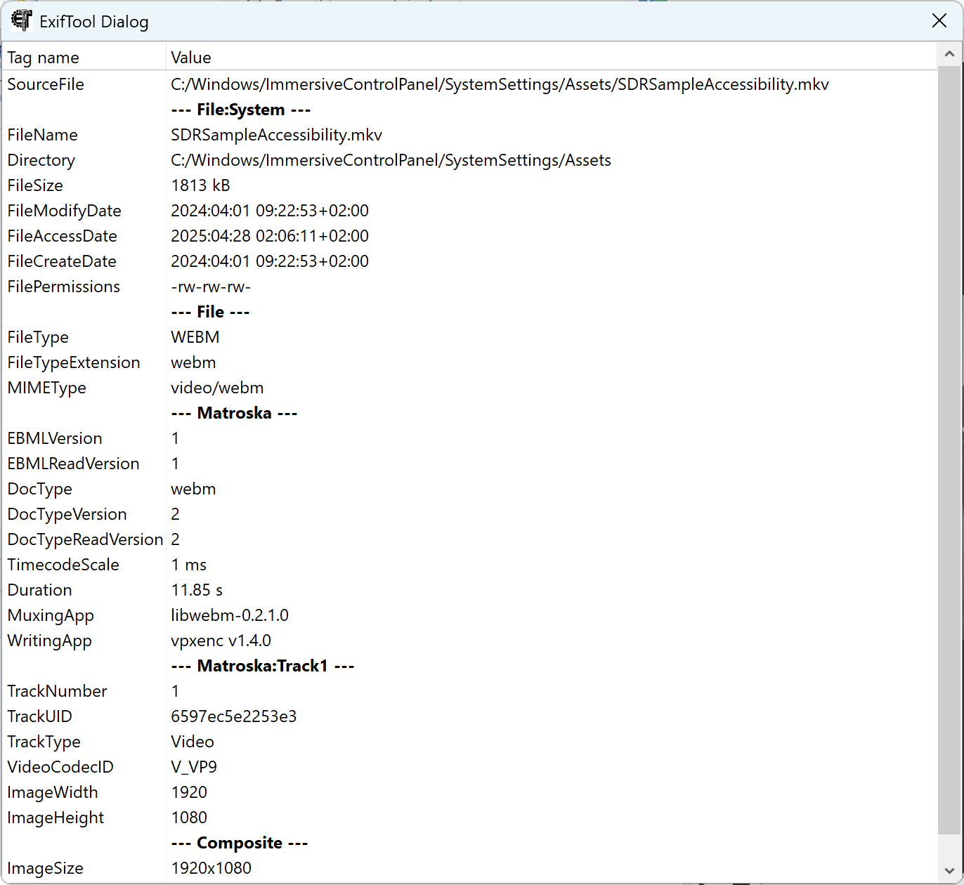

ExifTool GUI dialog
The plugin adds a custom command to open a dialog showing file's metadata using ExifTool.
Download from the Github repo: DirectoryOpus-ExifTool-Dialog.
Please read the README.md How to use section.

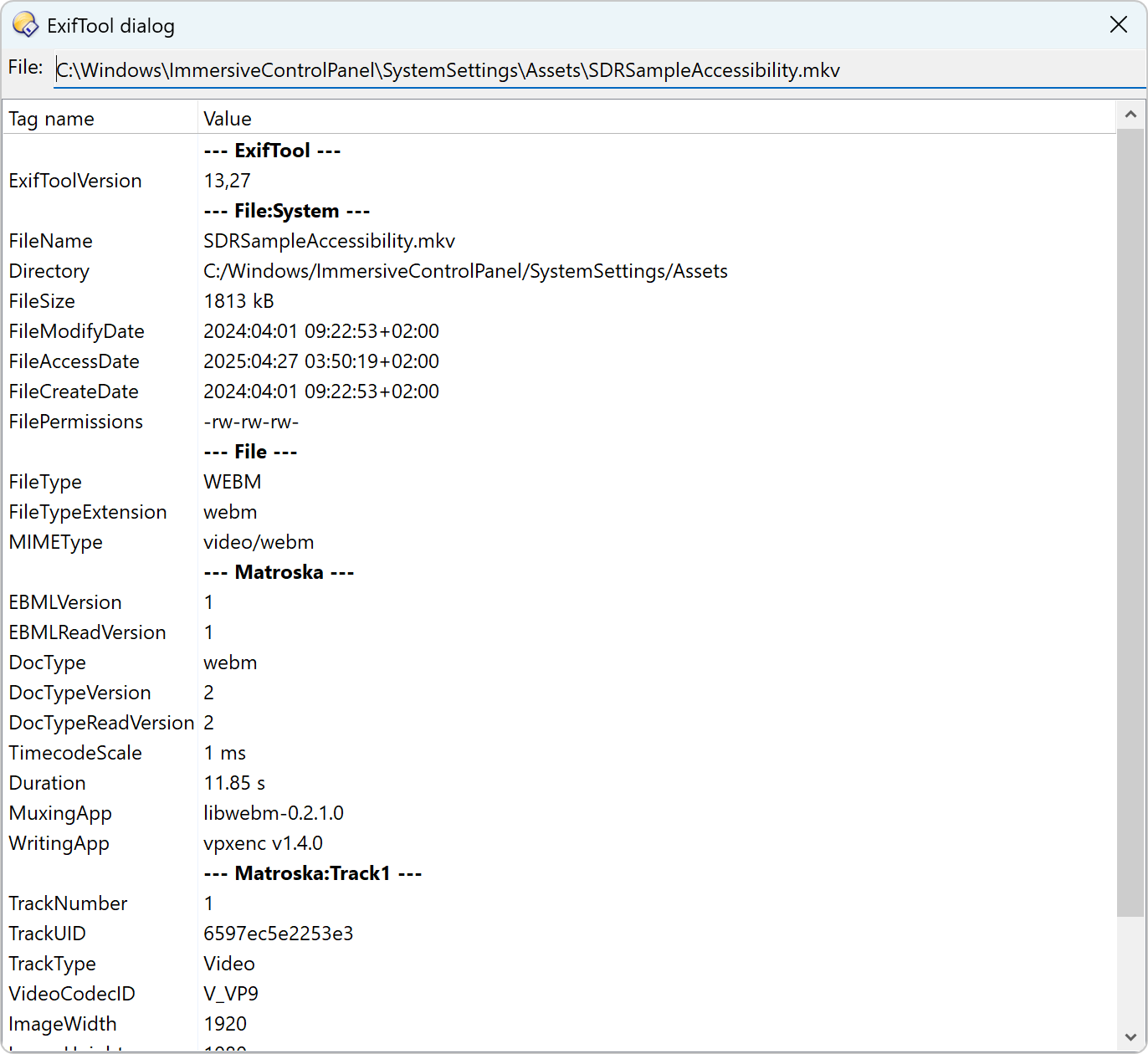

I have updated the plugin.
Changes:
  • Add an icon to the dialog
  • Don't show the ExifTool version
  • Make the dialog resizable
  • Use the FILE input parameter instead of a selected file.
If you used a previous version, you need to change the command configuration a little bit, Please check the screenshot in the README.md How to use section.
Got It !
The new version works fine.
It is only a five minute adjustment from the original version.

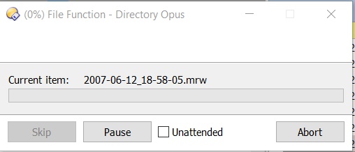

There is a small problem with the new version that was avoided in the original version.
If multiple files are selected, the program freezes.

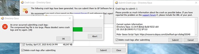

I'd show more detail, but I just got a DOpus crash log .
I'm able to show at least that part now.
I'll see if I can get both the window that freezes and the crash log.
I'll send this for now as I still can.
No Luck !
The crash log is too large to submit.
It really isn't that bad, exiting Directory Opus clears it.
It is caused by selecting multiple files in the new version.
I'll see if I can get a screen grab of the error as it occurs.
Nope, I need a computer restart to clear it.

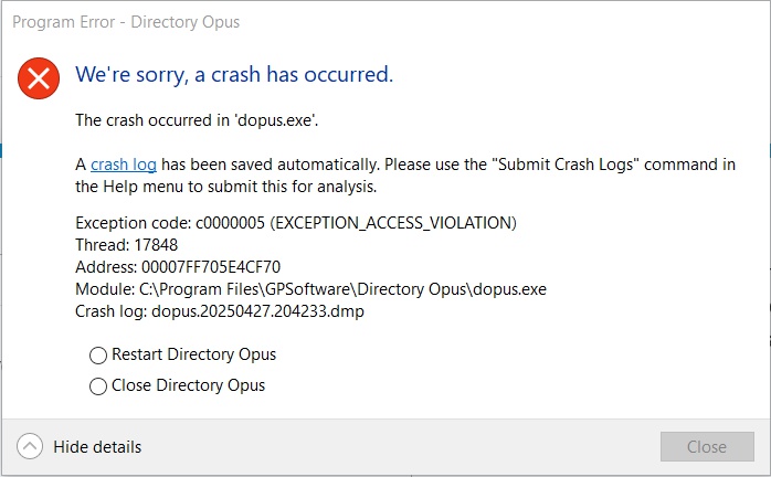

Here is the error as it happens.
I don't know yet if a @firstfileonly would fix this or not.
I had to do a restart to get this again.
Edit Note:
Hindsight is always perfect. Closing the pop up ExifTool dialog clears the error .

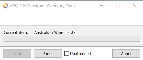

Does it happen with any files? For example, what if you select several text files?
Yes, It also happens with text files.

I have found what is happening:
Directory Opus automatically shows the File Function progress bar when a command is being executed with a file as a parameter. However, it seems that on Windows 8 and 10, this progress bar gets focused and sends the main ExifTool dialog in the background. That is why I didn't see this problem on Windows 11 because the ExifTool dialog is shown on top of this progress bar dialog. And because the ExifTool dialog is blocking, you can't do anything with this progress bar dialog because it waits for the ExifTool dialog to be closed.
