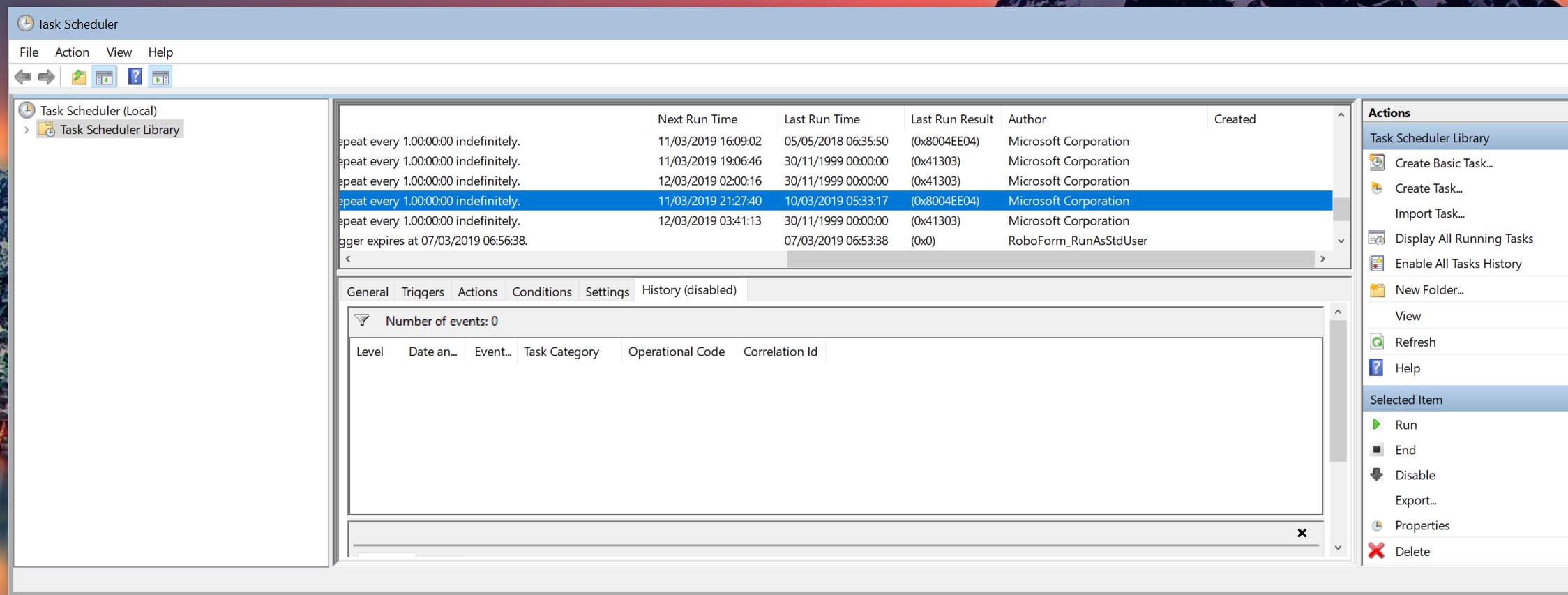

You may possibly onto something here, Leo. I started to research the auto update facility for OneDrive. It is run from the task scheduler. When I opened the Task Scheduler on my system this is what I found:
There are multiple tasks in place to update OneDrive. I have disabled all but the latest.
When I examine that task, I see:
Showing that the task is configured to run for Windows Vista and not Windows 10. Surely some mistake here?
This is a screenshot of the right hand side of the first screen shot:
Based on this information, I have disabled all of the OneDrive update tasks saved the last one to be run.
I have NOT changed from "Windows Vista" to "Windows 10" as I was not sure that this was the correct thing to do.
