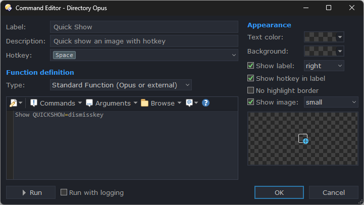

Button command:

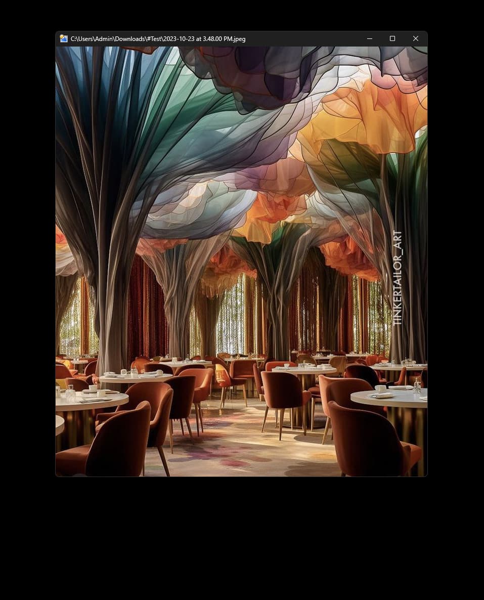

The result:

Simply select an image and press the spacebar, and the quick view will appear. Clicking anywhere outside the quick view will automatically close it. I'm also confused about the naming difference between quick view and quick show. You should ask the developer.

OK, I did not create a button with a hotkey but only a hotkey definition for Space to SHOW Quickshow=dismisskey. It sort of works, but sometimes opens and closes the viewer window
serval times before finally settling on opening it and then SOMEtimes it seems to be stuck open.
No, the machine I tried it on has no keyboard hook type utility installed.
Ah - it’s even weirder. When I tap the Space bar, it opens the viewer to stay open. When I keep pressing the Space bar, it opens, closes, opens again and THEN waits until I release the key.
I also changed to different keys to rule out a defective Space key or any interference, but the behaviour stays the same: Tapping the key that SHOW Quickshow is assigned to will open the viewer and then not close it. Keeping it pressed will open, close, sometimes open&close a 2nd time, then open and then wait until I release the key. I also tried with “,link”, same behaviour with one added detail: When the viewer opens for the first time and I press Cursor Left or Right before it closes, it will not close and stay open until I release the viewer key.

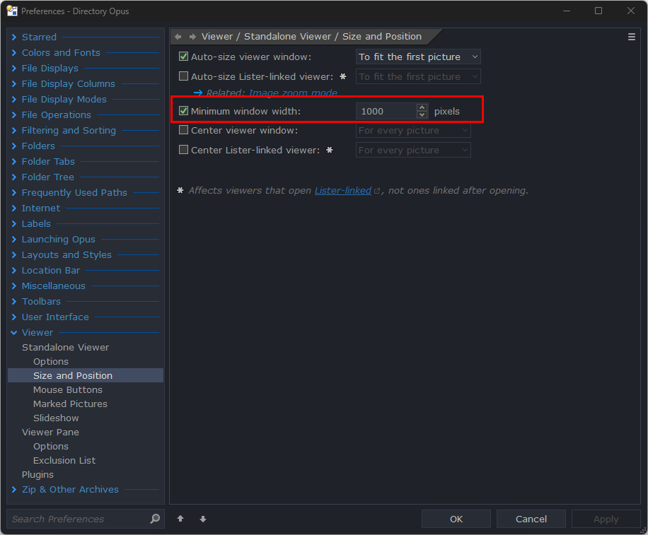

So far I have always opened the "full viewer" with the same size, but after the new "quick show" feature, the size of the "full viewer" always changes.
I hope that when I open the “full viewer'“, its size and position will follow the previous “full viewer” size and position, not the "quick show" position and size. The goal is to always have the “full viewer” size the same when I open it.
Or maybe add a maximum window width feature in the "full viewer" settings?

How did you configure the function? Space won't close it unless you have the dismisskey keyword in the command (e.g. Show QUICKSHOW=dismisskey).
