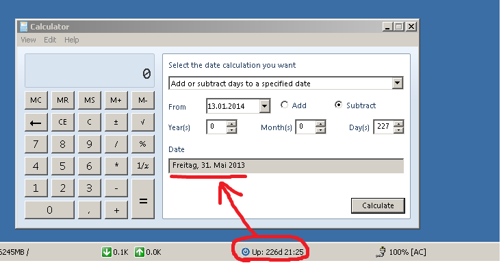

Did I mention my boss? He "forced" me to reboot my computer at work this january, after he noticed, that I did not restart the system for 226 days. As this was my personal record, I needed to take a screenshot of winbar and was curious about what exact day it ways that I started that machine. o) (Calc.exe handles dates as well, did you know?)
