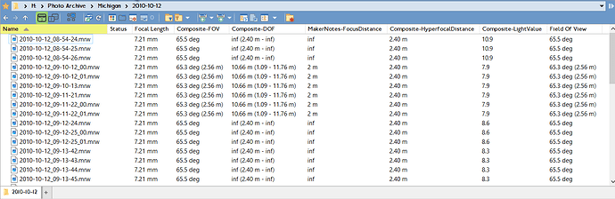

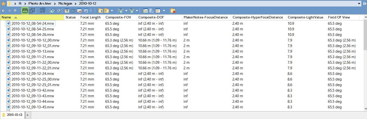

I am a loyal user of @lxp 's script, but I must confess that so far it works very well.
This is a folder format using @lxp's script with the column to the far right being a test column from your version.
This is as far as I am on this as of tonight.
Thankyou for your contribution to this.

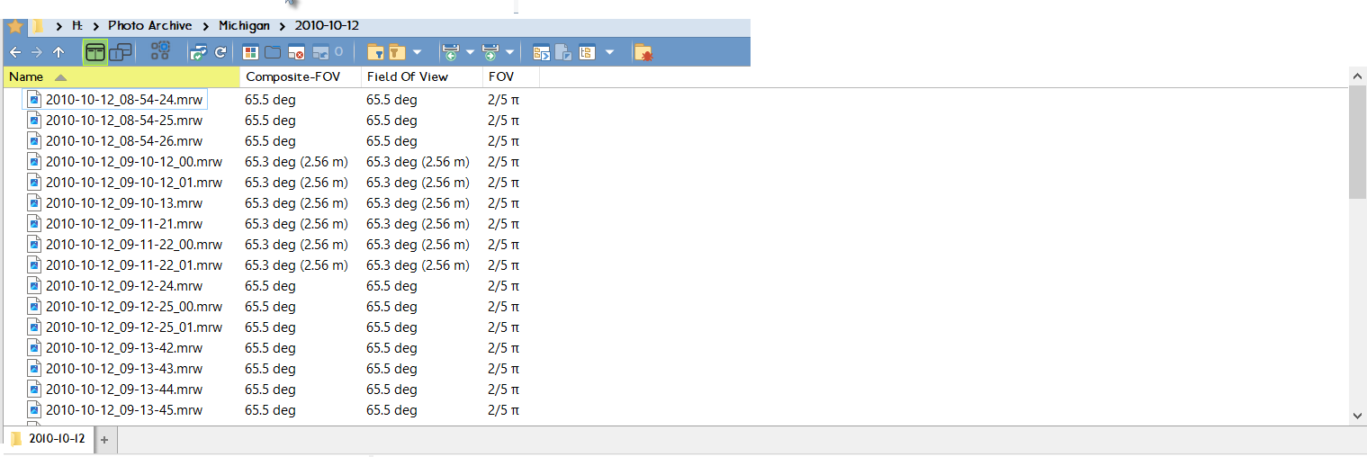

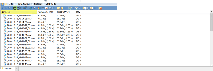

Edit Note:
With my homemade Evaluator Field of View Column this page is all 2/5 π .

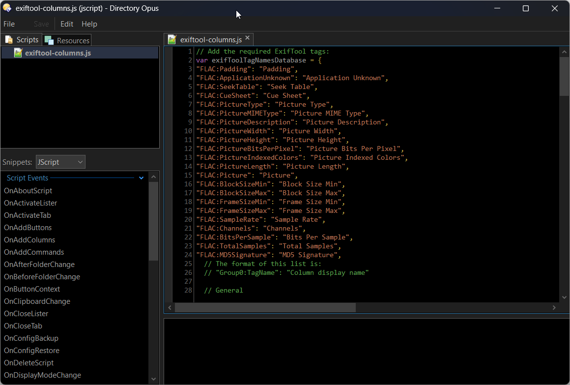

I don't know how to "Modify the exifToolTagNamesDatabase variable at the beginning of the script file".
So I added tag/column names to the 'default' tags listed:
I added this line:
I saved the file.
I do have the Dopus Scripting Extension installed, and I know it's OK because the MediaInfo ++ script is working.
Does anyone have any idea as to what I might have done wrong?

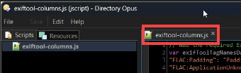

Did you add it at the beginning of the script file?
Well...yes, but I could not figure out how to edit the dialog in your screenshot, so I opened the .js file in Notepad and edited that. (because I'm clueless!)
I can't figure out how to add to this as you did.
Thank you for your help.

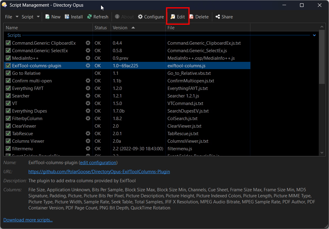

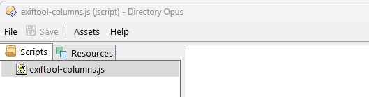

Settings - Scripts... double clicking the script or the edit button.
I think notepad has changed the coding of the .js file. You should download the file again and then change it in dopus own script editor

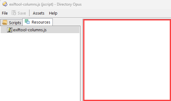

I started over with an unedited .js script file, but I still can't add to the area outlined in red below:
or even display the filename as your screenshot shows:
I'll keep trying....
I got it!
this box was checked. I might have checked it, but not sure.

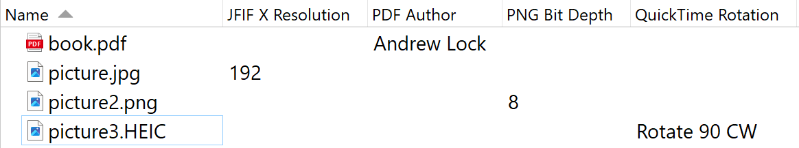

I have updated the plugin. I have fixed a bug:
  • When tag data is an array, display the data as a semicolon-separated list.

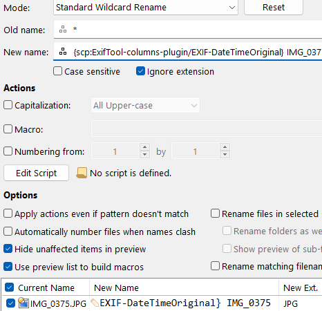

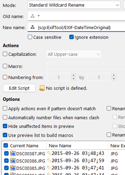

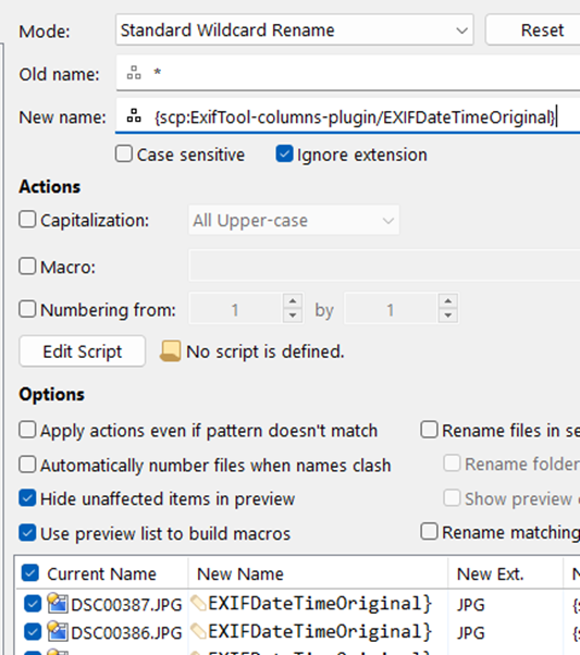

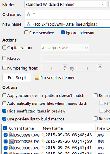

I just found out I can’t rename files by date as I was able to with the other ExifTool Script. Do you have any idea why?
Other Script:
It seems to be a bug in DOpus. The New name editbox eats : symbol. That is why the column name is incorrect in your first screenshot.

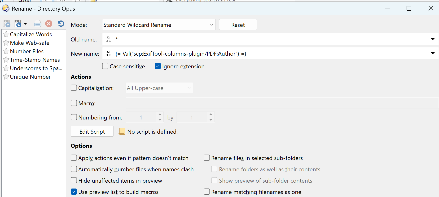

Try to use different syntax:
{= Val("scp:ExifTool-columns-plugin/PDF:Author") =}

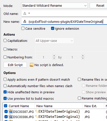

Column keywords shouldn't have : or other path separators or space in them, if at all avoidable. It will cause problems in a few places.
(We should probably add a warning or similar if script columns use those characters.)
Using _ or - instead of : should work fine, as an alternative.
Thank you, but I am unable to add the quotes or the semi-colon in the Rename dialog.
I was able to do other editing, like adding a space or a dash - just to see if I could.
no luck when replacing with a dash or an underscore:

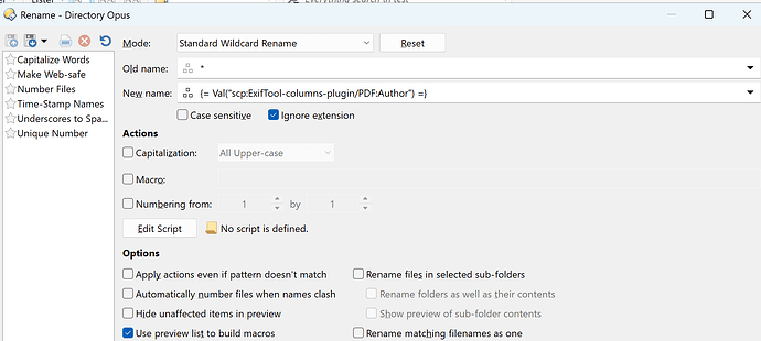

@MegMac,
It works on my machine:
Ok, I will change the naming in the next version.
