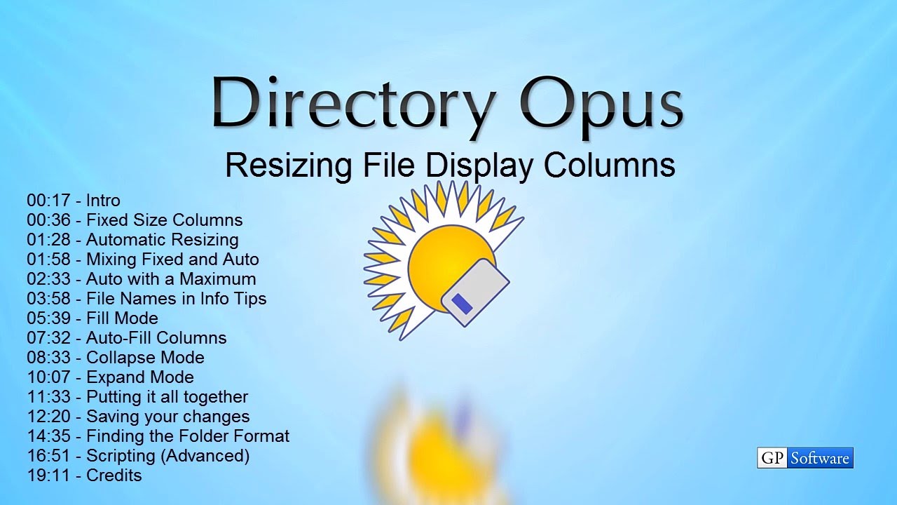

Video tutorial:
The tutorial on Resizing File Display Columns covers some of the same ground as this FAQ, in video format. The tutorial also covers other related subjects in detail.
Head to 12m20s in the video for the parts about Saving Your Changes and Finding the Folder Format for the parts most related to this FAQ. Or watch the whole video to learn about the different types of column resizing.
